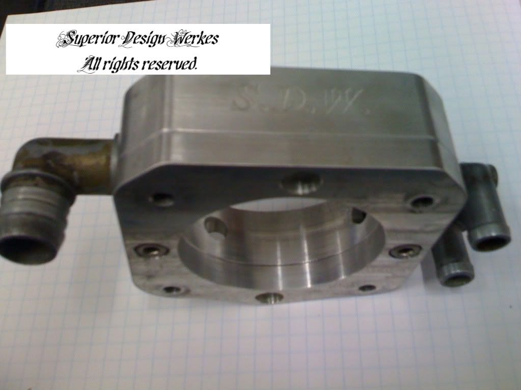

    OK R3V, the reason for this feeler is for market research. For the past few months I have been working with an aerospace engineer who owns his own shop. He and His brother have their own business and have been close friends with my Father for years. We have been working collectively to design an adaptor to mount the M30 T/B to the M20 manifold to increase airflow for all you turbo,stroker guys. We are 90% done with final test fitting to be done on my car Friday. After the necessary hones for the booster have been finalized I will be taking it to the dyno for HP #'s. I am putting my all in this product as fabbing is in my blood. A BIO on me: I grew up bimmers, My dad has had his BMW shop since 1987. I have allways been into motorsports especially Bimmers. I started wrenching with my Dad since 92 with more of the mindset of motorsport. I have worked with the likes of T.E.P, RMS and other tuners in Cali and NV. This will be our first product as we venture into motorsports. Before I push my product to major tuners, I would like to offer my product to R3V members. Feel free to ask ?'s and interest about this product. Thanks again for taking the time to read this post.

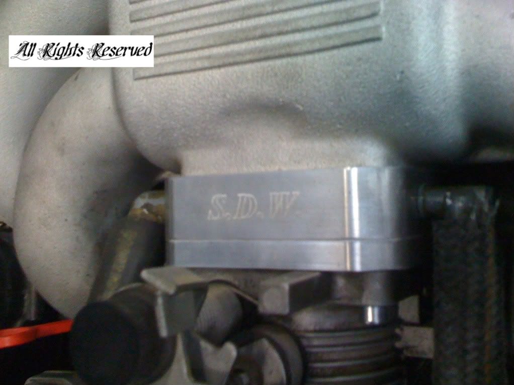

    Here are some teaser pics. Will be doing some more test fitting on my car this Friday.

    Have you considered working with a larger throttle body than the M30 to adapt? This only gives you a 4mm increase of which you can modify a M20 TB to fit the M30 plate.
    Have you looked into what size plate will fit a M30 TB? And have you considered offering this as well?

      I have looked into larger throttle bodys...I chose the M30 because it is compact and will work with the existing throttle cable with minor adjustments. 4 mm is a significant increase. I appreciate your feed back. Just what I need in this thread.

          I saw the prototype today. Looked awesome. I can see this mod becoming pretty popular :D but of course, as kamotors said, numbers are key.

                        You are not the only 1 maniac...I will be installing the proto this weekend and hopefully going to the dyno few days/weeks after that. I want to do some real world testing to make sure it will function the way I am wishing it will.

                          I am interested. Would this allow the use of the stock intake elbow + afm + air box? Or will the extra plate push everything out all weird?

                            I will be testing the part tomorrow with the stock parts and without. I am currently running an M30 AFM but will bolt on both products. I will give you more info this weekend. But yes I am designing this so we can use the factory intake boot. A new boot will go around both the m30 AFM and throttle body.
