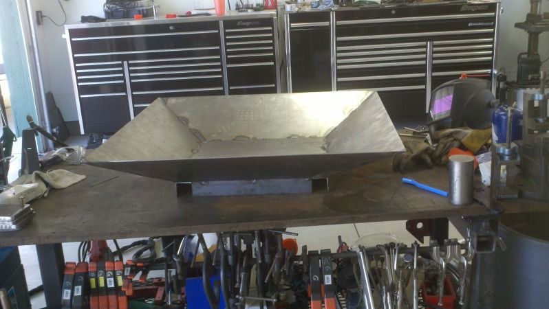

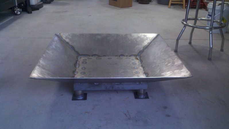

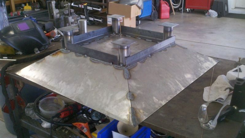

    next i started making a fire pit for the back yard

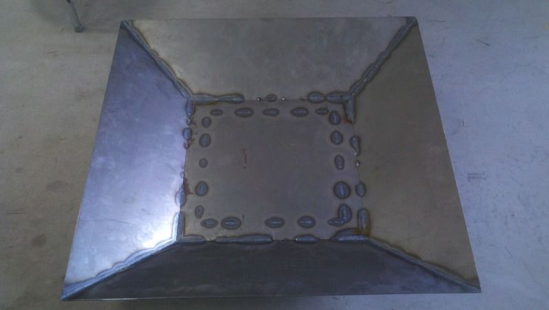

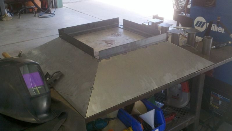

    base and sides all tacked together
    frame done

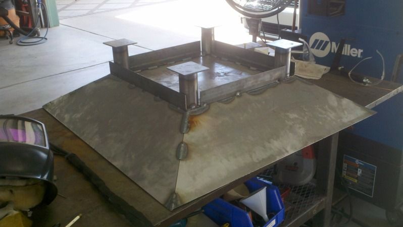

    tacking the feet on. the feet are 2 1/2", 1/8" wall (squared and trued in a lathe) with 3"x3" 12 gauge squares welded to them.
    a little more progress and more welding.
    bottoms of the sides fully welded, the frame stitched on the insides.

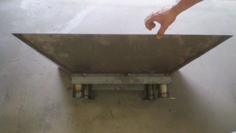

    feet welded on, inside stitched.
    good stopping point until next weekend
    next weekend i will finish welding it and cut the bottom for 2 3"x4" squares of perforated 10 gauge steel for convection. i also need to make the filler pieces for the gaps in front of the legs.
    i "might" start hunting for a propane bottle, burners and lava rocks to put in it after i burn up the wood i have (i have about 1/3 of a cord from my mesquite tree in front of the house)
    the specs are:
    19" base
    10" sides set at just under a 45* angle
    over all OD
    height
    i might start on a second one for a friend also.
    i will post up finished pics next weekend.
    NEXT: i am going to start on a new park bench for the front entry way of the house.......over built of course. :D

        God help the person that falls on that fire pit corners haha. Looks great though Greg. LOVE the waste basket, needs a white trash bag to make the holes pop.

          i will give the corners a nice radius when i am done.
