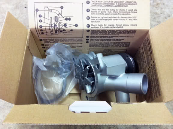

Some have impellers like this one attached
Others like this:
Not sure which is better

as for the pics. the 1st one looks to be oem. while the other looks a cheeper option. the increased number of impellers on the first one would provide faster and higher volume of water flow.

As for the differences in the different brands available, what's already said is a bit incomplete. 5toes, the water pump you've pictured on top looks to be GRAF pump (and if I'm not mistaken, from the IE website), the pump on bottom is the GMB pump.
Brands:
Hepu: Good (carousel style impeller)
GMB: OK (fan syle impeller)
Graf: Good (carousel style impeller)
Meyle: OK (carousel style impeller)
Laso: Good (carousel style impeller)
OEM (Saleri): OK ("composite [plastic] impeller")
Keep in mind that availability constantly fluctuates on all these (which is why most of us resellers don't list a brand). I like to keep Graf and Hepu on the shelf, but sometimes have to substitute a Meyle (customers of just about any reseller/shop can always call to specify a preference). The ONLY ones I've seen fail to with any degree of consistency is obviously the pumps with the plastic impeller. ALL OTHER pumps function relatively well and shouldn't be cause for any catastrophic engine failures.
If you want to get REALLY technical the fan-style impeller does not push quite as much as a carousel-style impeller, but at that stage you're really splitting hairs and it's MUCH more likely your cause for overheating is something (anything) else.
