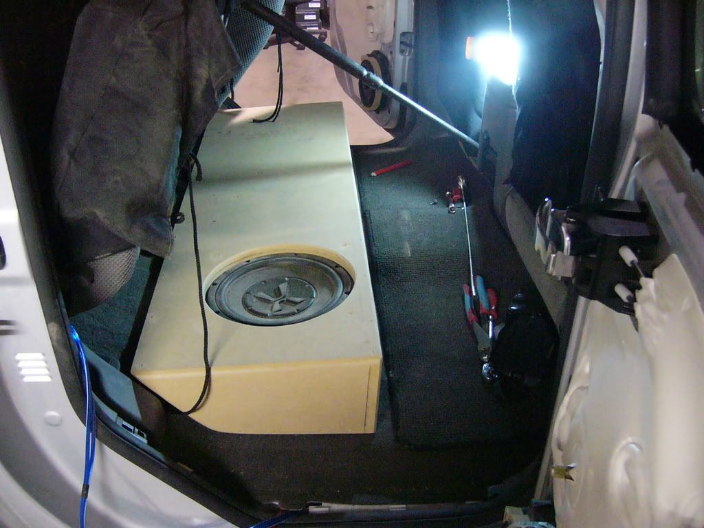

    OK, so this guy wants nice bass, but he bought a 2005 Nissan Frontier.
    OOPS!

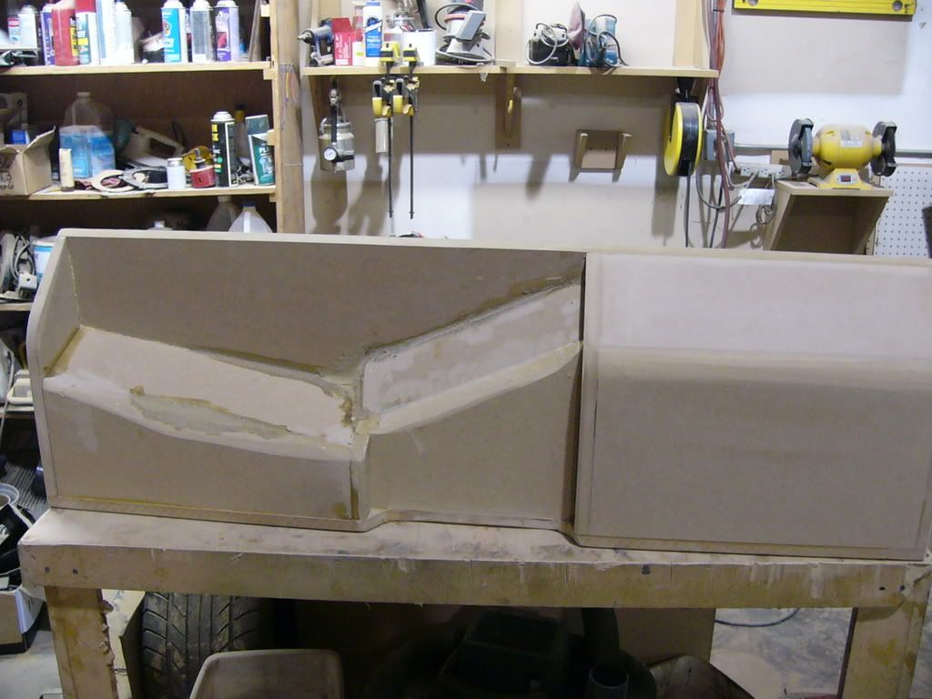

    Exile to the rescue, the XTech 10" woofer is only 3.25" deep...but still kicks ass. The box I built for him fits so precisely that it amazes me, and I built it.
    So, since this thread is worthless without pics, here ya go:

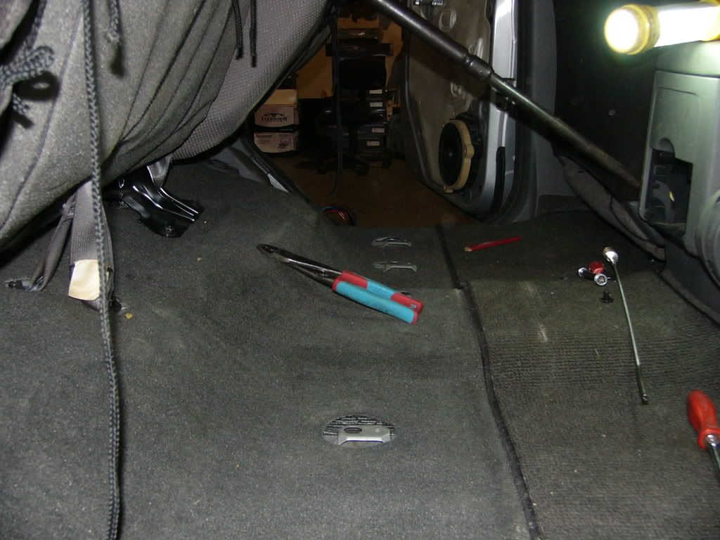

    Under seat space:

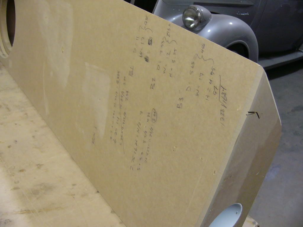

    Just a bit of math:
    The back of the box:

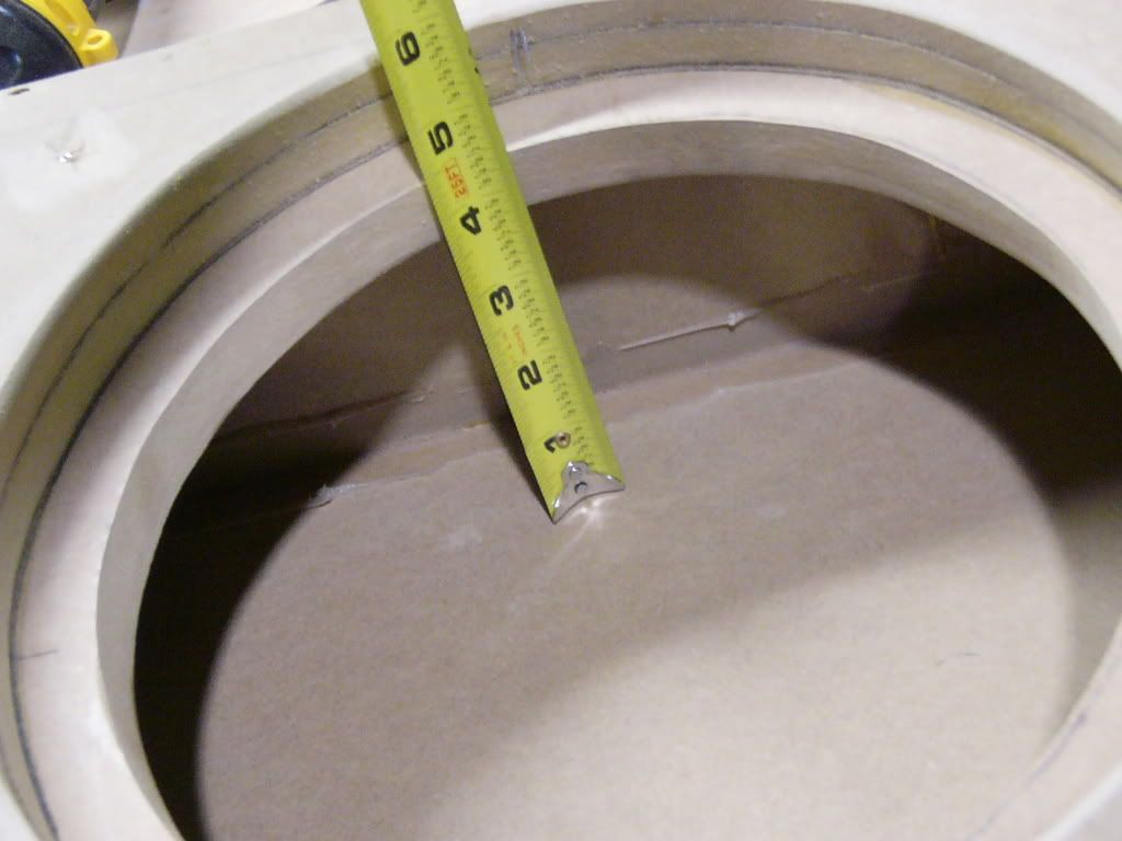

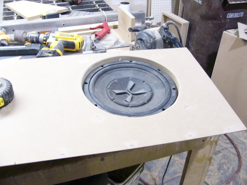

    Room for this woofer?
    Yup, it fits:
    Does it actually fit in there?
    So, yeah, it is all dusty, and dumb old me forgot to check to see if I had proper carpet, so I have to run over across town in the morning to get upholstery, and wrap this job up. The two amps are going behind the rear seat, Exile seperates in the doors/dash, Exile co-ax in the rear doors, 2 Exile amps. Should sound great, but this box has been a bitch.

    fiberglass is your friend...
    Originally posted by Simon S
    • StereoInstaller1
      GAS
      • 22679
      No, it is not. I could have gained like maybe .2 cu.ft, but I would have spent $100 more in materials, taken 2 days longer, and most importantly stunk his car all to hell for months.
      I hate fiberglass and just about won't do it. Can't make it sound as good either...no 'glass box I have ever heard comes close to mine.
