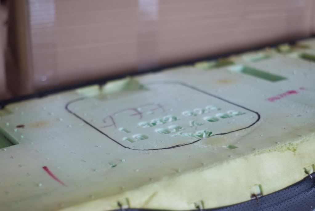

    First youll need to cut some foam from the rear seat (recommended to do this to pretty much all luke boxes unless you havea seat you dont want to cut into)
    Trace with a sharpie using the skipass:

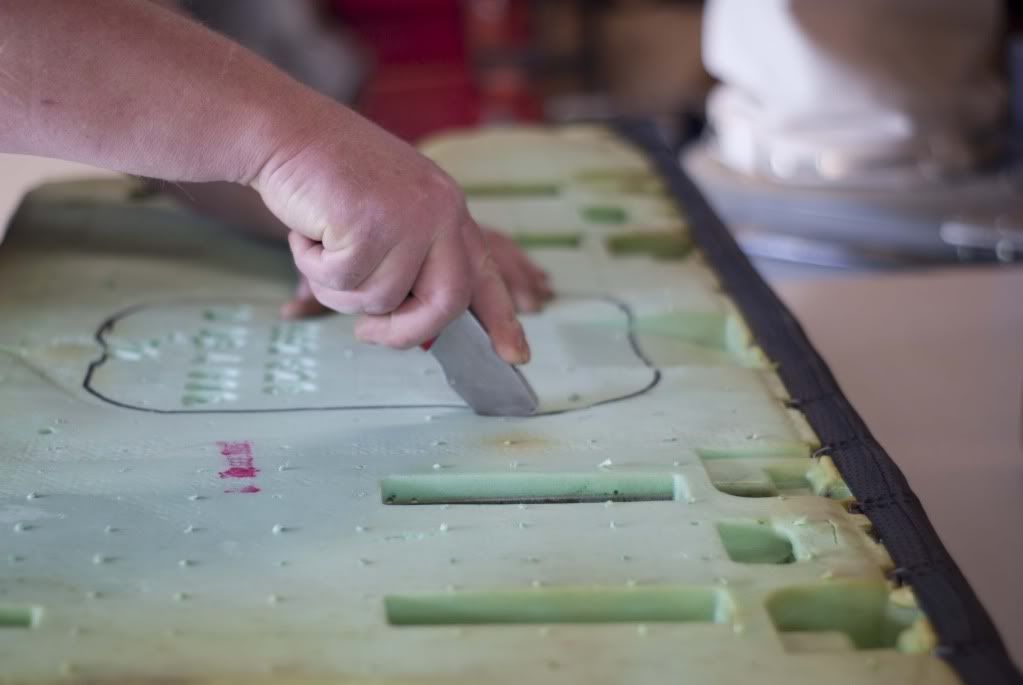

    Cut it about an inch deep, or roughlyone utility blade:
    Doesn't look like this? put the knife down and step away:

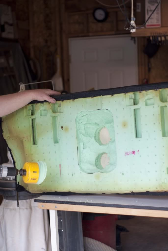

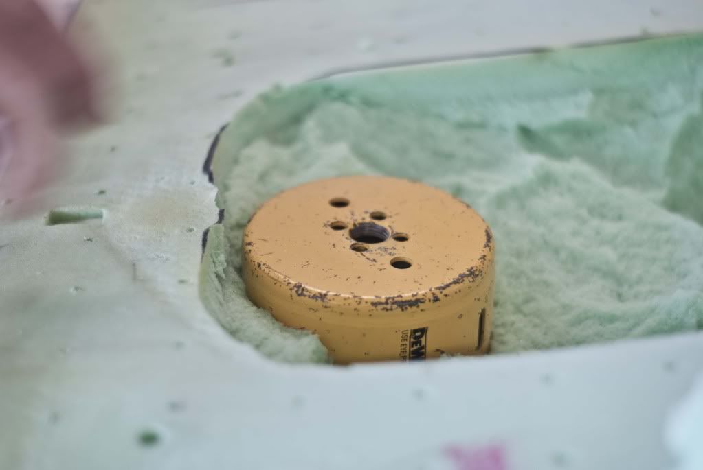

    Shear the rest of that shit out and get a holesaw the size of your port.
    twist it and make a hole:
    in fact, make 2:

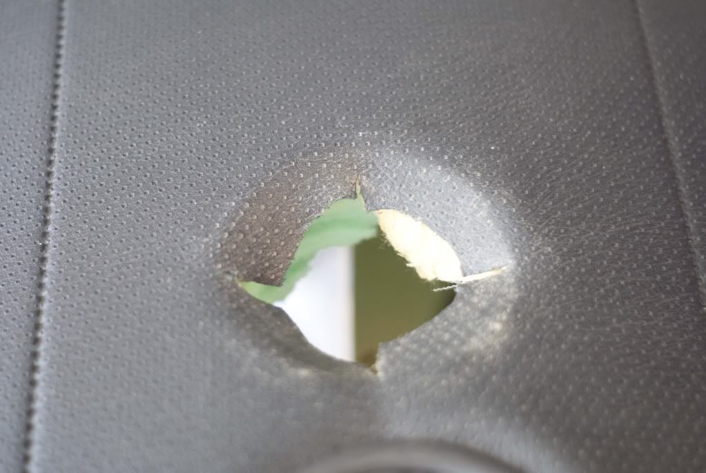

    Carefully align and cut into your seat. Cut out a circle a little smaller than the port and slot it a little farther past that, being carefiul not to go to far and have a slit showing or loose fit

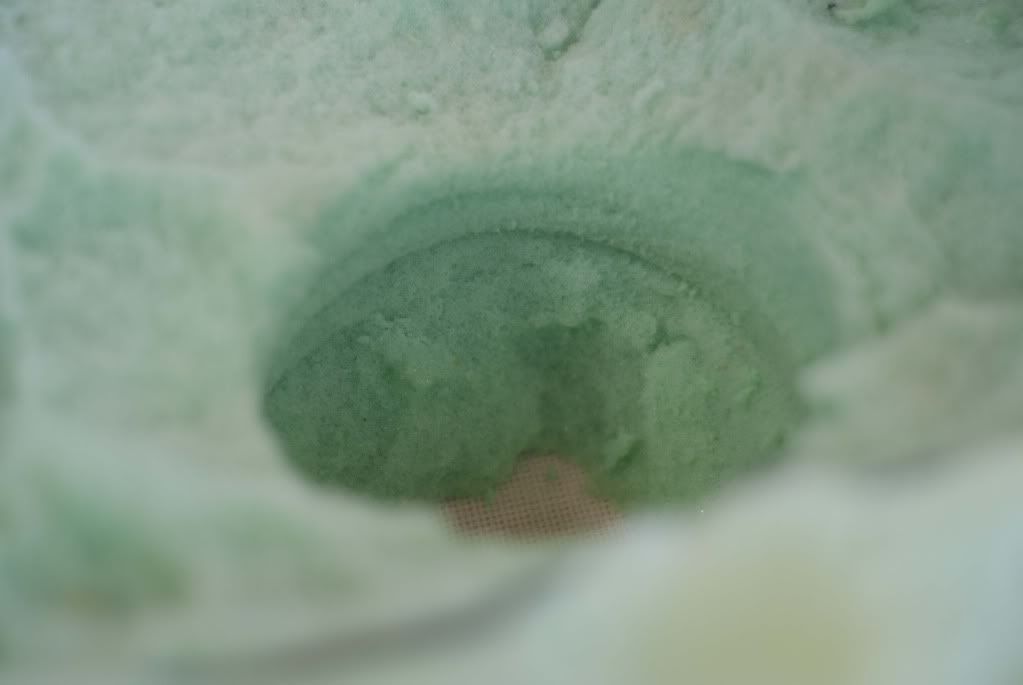

    Heres the ports just sitting in there after cutting. You will want to tweak it as you please. When i remove my seat again finishing up my install I will try some adhesive to get it to lay 100% flat, and update the thread
    As far as sound, this makes a hell of a difference getting the bass into the cabin, as opposed to firing through a shit ton of seat foam. Enjoy
