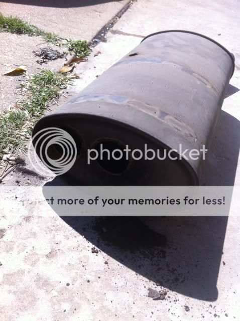

    First, we remove the Exhaust and found the muffler is gone :rofl:

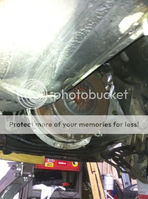

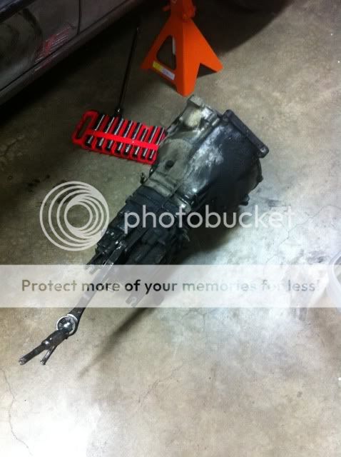

    After, 10 hours trying to figure out how to remove the top starter bolt and top dead center bolt we got the transmission out :D
    Pressure Washed the G260 and all is clean now :D

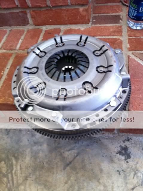

    Picture of the twin mass flywheel, clutch and pressure plate. As you can see it really needed a new one.

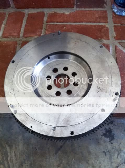

    Here is the new Flywheel (4 lbs less then the Twin Mass)
    Test fitting the new clutch before bolting it up to the engine.

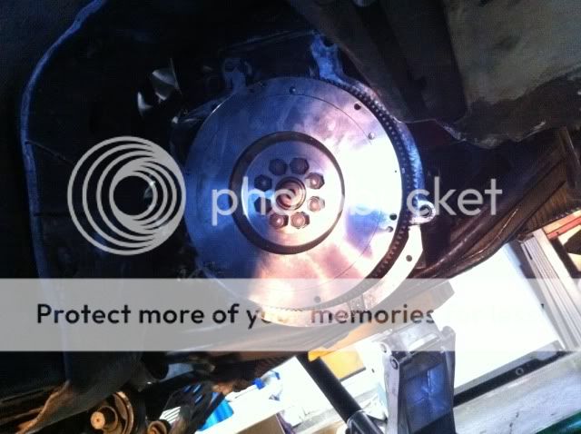

    The flywheel is mounted with new bolts.

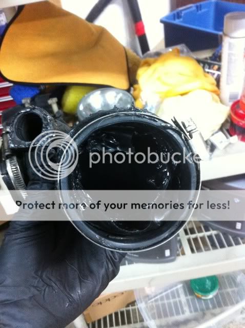

    Installed new Intake Boot. As you can see the old one below..:facepalm:
