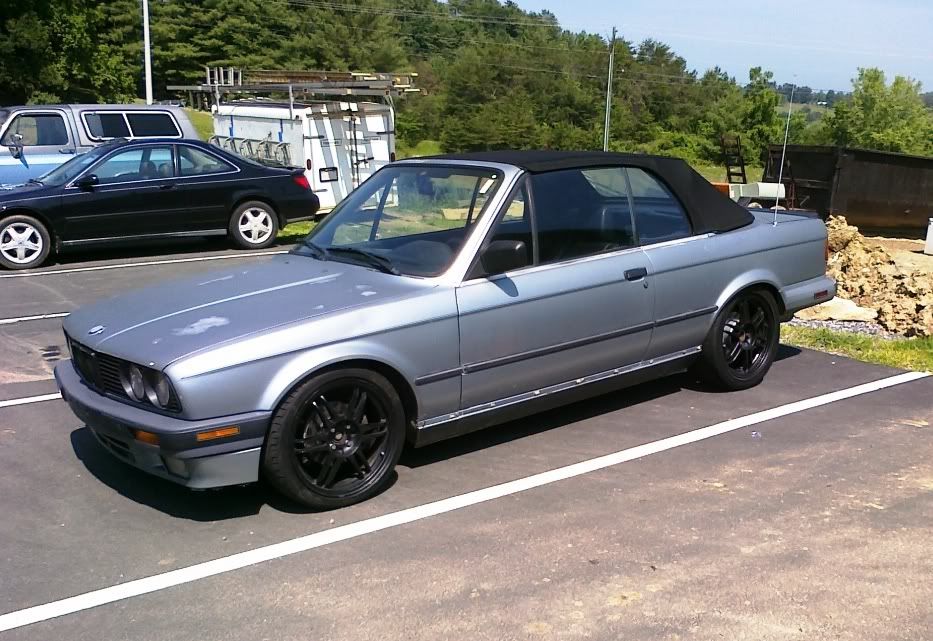

    A Picture as of 7/31/11!

        Vert needs more low IMO and baller wheels ;) But painting the wheels on it now helped a TON. I like the 325is, I think that will turn out better with some more loving.

          I autocross the vert, Yes I know they aren't the best racers but it is f'n fun, so I dont want to get crazy low. I intend on getting the stance right by dropping the rear a little more. As far as the front goes, when the volvo lip is on I only have 2.5" of clearance.
          Oh and much much more love is on the way for both my babies!!
          Oh and the wheels that were on it when I bought it were American Racing wheels made out of concrete. I got lucky on the light weight kosei's
