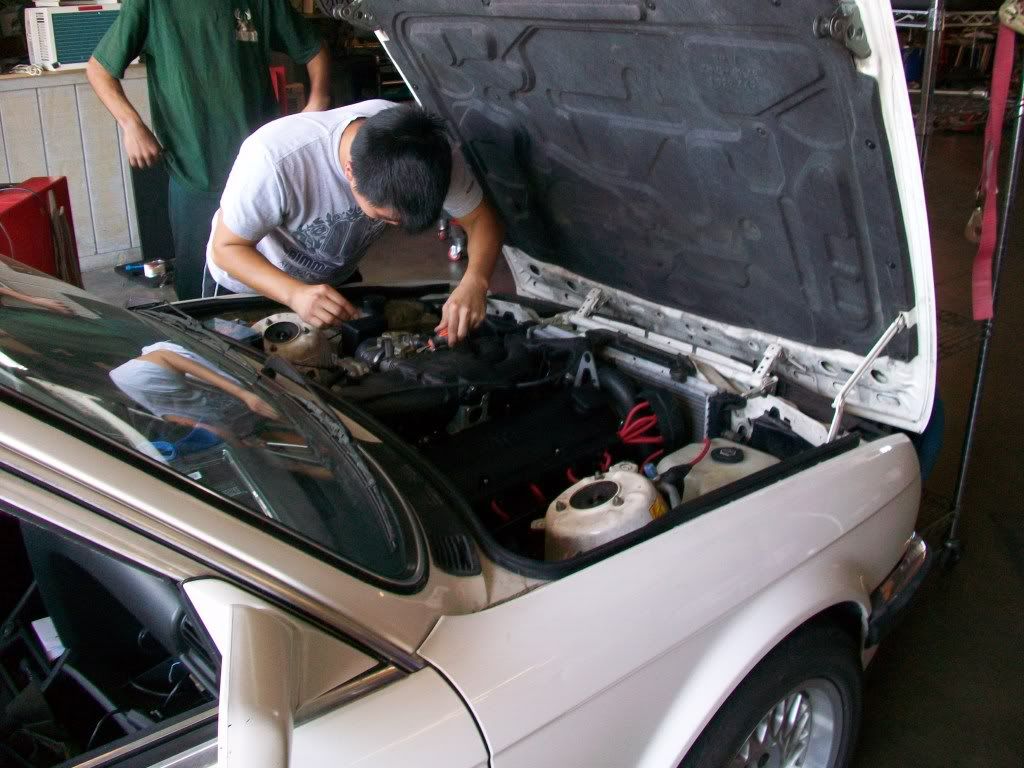

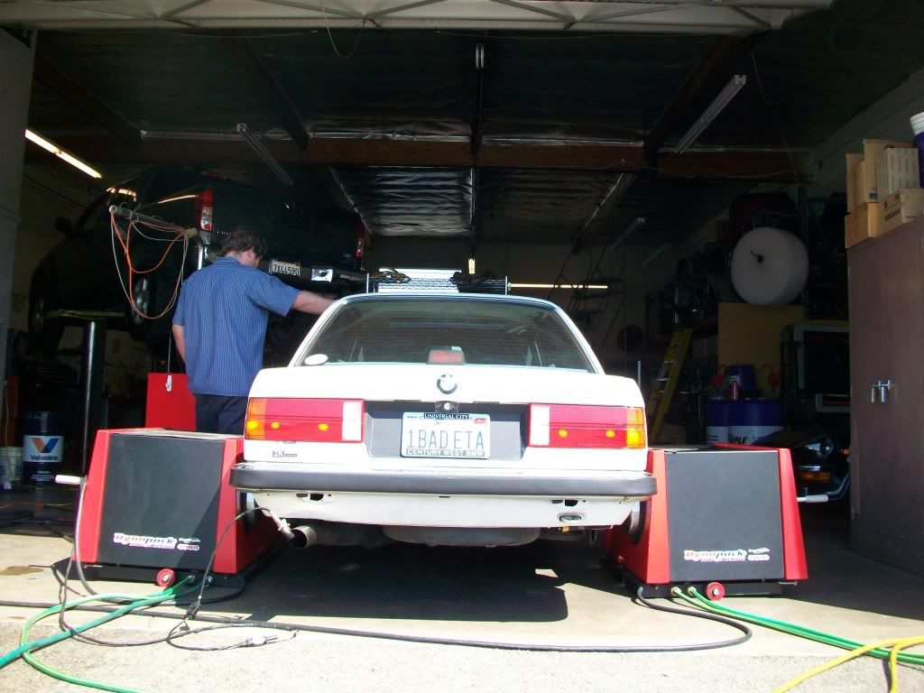

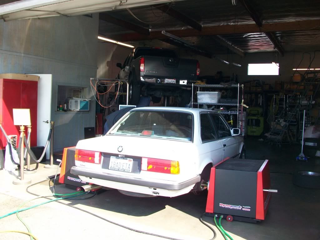

    Finally got my new (1500 mile) 2.8L stroker dyno tuned. Megasquirt and tuning were done by Derek aka blueapplesoda here on the forum. The engine is rebuilt top to bottom with the help of H&H Flatheads in La Crescenta, CA. Car was tuned this past Tuesday morning and made 184whp & 191 wtq. The intake air temps were very high, car should make more power once I get a airbox/heat shield on there and go from a 2.5" intake pipe to a 3" pipe.
