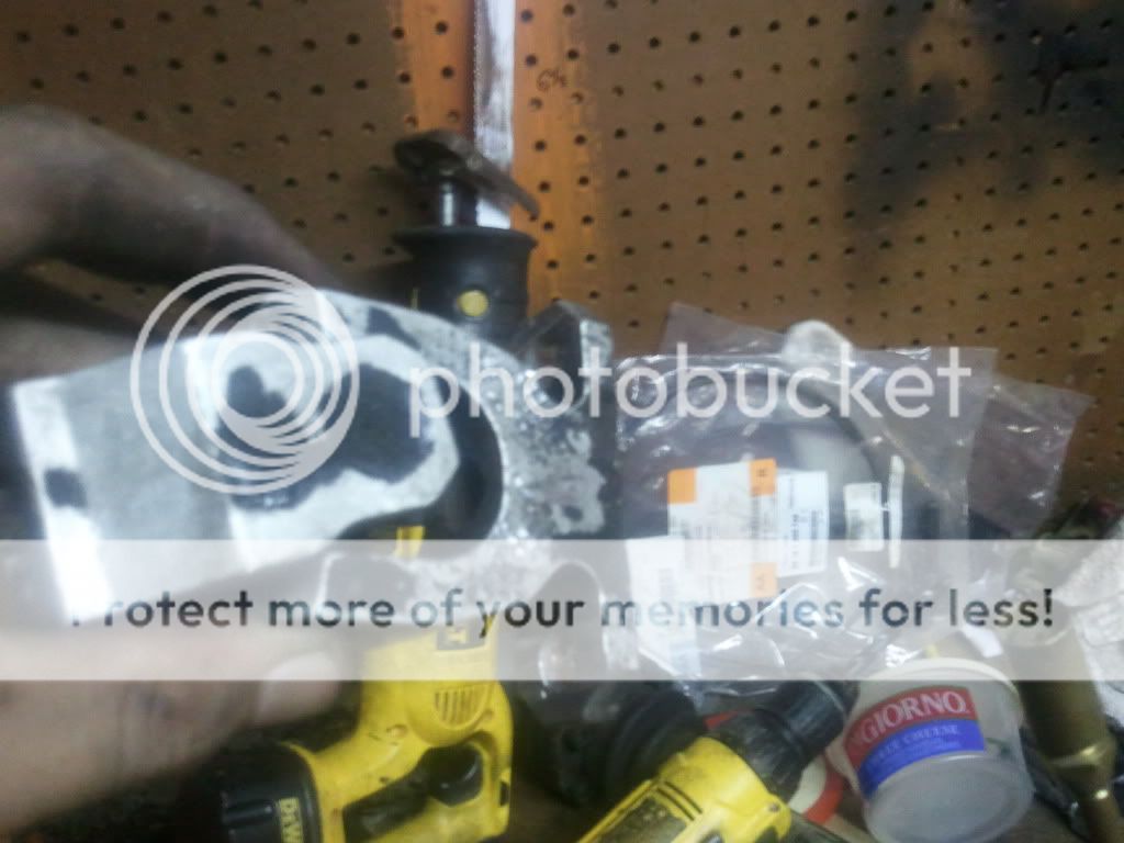

Once you have the joint out put it in a vice for the operation.
Will need something to cut metal, a hammer, a center punch, torch, a drill and metal cutting drill bits, and some strenghth and will power.
cut and drill the rivits and punch them out.
avoid cutting into the joint itself (like I did)
Also be carefull the joint is aluminum.
here is the guibo, notice the belts inside are coming out. This one could have lasted a little longer but I did this anyway.
here is one of the sides of the joint with the rivits removed.--^
NOTICE!! there is a plastic cylinder peice that IS NOT PICTURED! It is in the middle of the guibo, it keeps both shafts lined up. Keep track of it to reuse it.
(actually it is pictured in the last picture in its proper place in the center of the joint)
