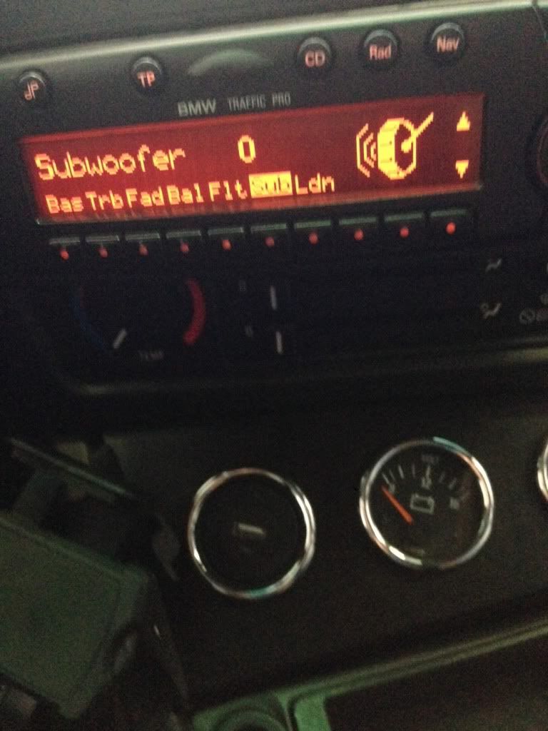

    One of the best things about the 4773, besides looking oem, is that the sub can be controlled from the HU. Here's a pic of the Traffic Pro, which I paired with a 5-channel Soundstream amp, an 8" Alpine Type R subwoofer in a Lukebox, and oem premium speakers front and rear.

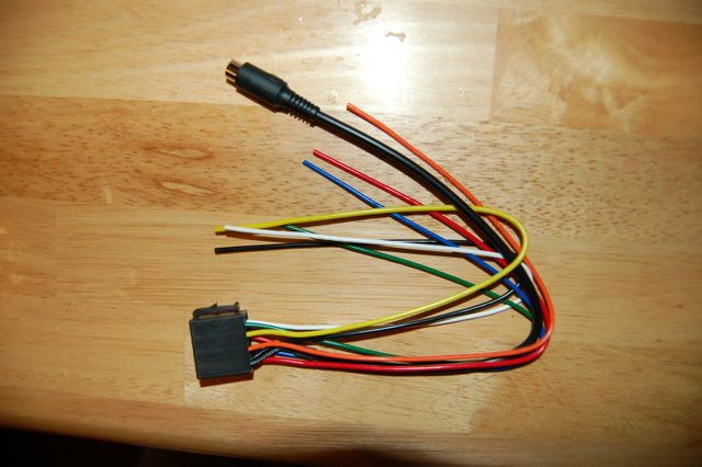

    But, when I had the Toronto in the vert, I was never impressed with its sound quality. Once I installed it in the sedan, however, I realized how much better it sounds with the better quality Soundstream amp and Alpine subwoofer/Lukebox, as well as the sedan's better acoustics. First off, I didn't realize the Toronto had a separate subwoofer pre-amp because I was using the wrong power harness. This is the one I needed
    The sub gain settings range from 0 to 4, which is enough to dial in the bass for my music tastes. I'm not that particular though, sometimes I even use the preset Pop and Rock EQ settings when I want to change things up.

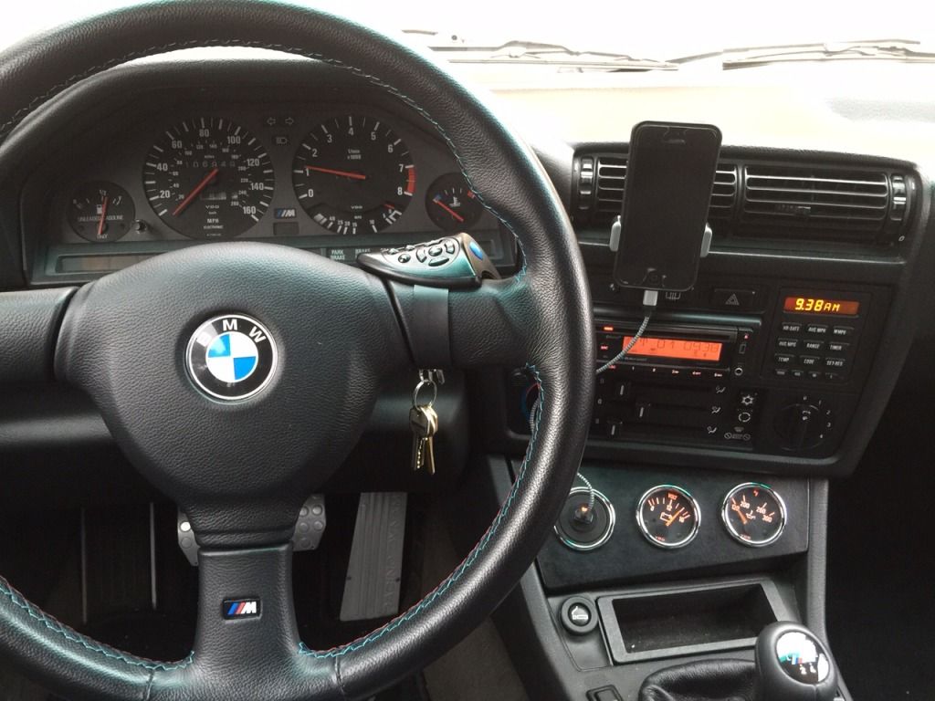

    A couple small complaints - the FM reception isn't as good as it was with the 4773, but it's not bad (I use a Z3 antenna). And the front USB outlet uses a since deprecated micro USB cable, and it doesn't charge or read music from my iphone 5. The varioclour allows you to dial in the amber to match the e30's interior well, but it doesn't match the lighting style of the OBC. Here's a pic

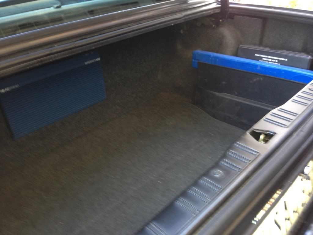

    and here's the soundstream 5-channel amp and hidden 8" Type R sub/Lukebox

      I use my sedan as a daily driver, so the only thing better than bluetooth is being able to control the radio without taking my hands off the wheel. Enter the Blaupunkt RC10 steering wheel remote.
      It's an infrared remote, so it needs to be pointed at the Toronto BT400 to work. On a side note, the Toronto BT400 has the infrared receiver built in, but other radios that don't have built-in infrared will require the infrared receiver to be remotely mounted using a harness that plugs into the back of the radio. I mounted my remote on the right inner spoke of the steering wheel so it doesn't get in the way of steering. This location also allows it to point directly at the radio.
      The remote allows me full access to all my music, and to control the volume, including mute. A couple small drawbacks - the infrared remote loses connection to the radio if you turn the wheel far enough, so you can't change channels while you're making a U-turn. My other complaint is a little bigger, there's no button on the remote for answering the phone, wth. Oh well, I guess ten years ago when the RC10 came out, it wasn't that big of a deal.
