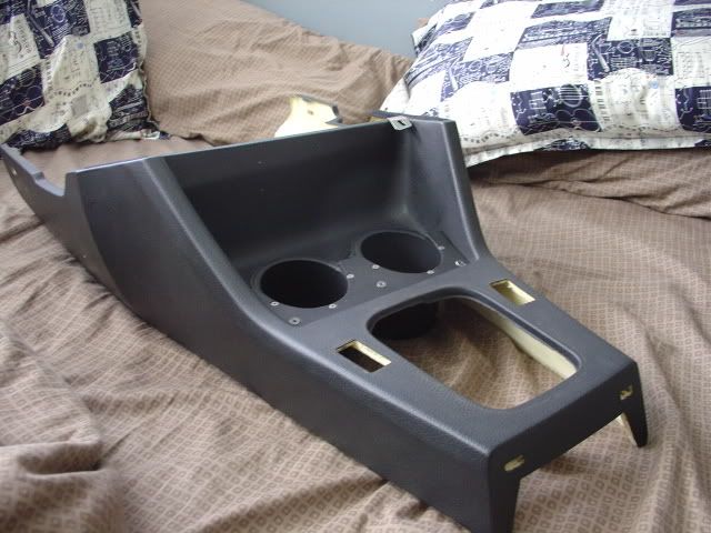

    Well, I can't really do much, since I'm waiting for my new lift to come in. So i had a spare forward console or whatever you call it and decided to try and make a cupholder for it...tell me what you think...
    Its all ABS plastic. I think the screws are too much...i may revert the 3 larger ones back to black to be simpler.

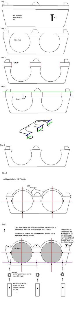

    Ok heres the write up part.
    TOOLS:
    Hobby knife
    files, assorted
    sandpaper, 300-500 grit
    heatgun
    drill
    bits, small and large
    bench vice (not necessary, but alot easier)
    --Need something to clamp to bend 90 degree angles while the plastic is hot
    hack saw/pipe cutter
    Materials
    3.5" ABS water pipe
    ABS sheet, preferably 1/8" or thicker
    screws of your choice, or epoxy if thats what you fancy
    Make Cardboard prototype, tracing the ashtray on a peice of card board and cutting/bending.
    --Ok heres the part where you can do one or the other.
    ----Make the rear end, the part you don't normally see on the ashtray, make it smaller, so when you cut the abs pipe, you don't have to cut in an angle.
    ----Or you can just copy the shape of the ashtray, but beware that you have to cut the pipes at an angle .
    Here is a diagram, that should take you through most of it. the rest is common sense.
    I changed the larger screws back to black...Its not so...out of place now.

    Looks good. Might look better with the screws painted black. But the most important thing, how does it work?

      Very interesting! I like it a lot, a very good idea!
        yea, how much clearence is there to fit a good cup in there? Looks like it would hit the hvac panel.
        looks good nonetheless!

            it fits gatorade bottles no prob, and I will NEVARREVARR drink from an open cup in my e30. It won't fit a coffee cup, but most cup sizes do fit. its about 4ish inches deep and 3.5 inches wide...i might be adding some flaps in there to make it nice and snug....i have to test it though, since im a little skeptical of shifting in 3rd (maybe too close?).

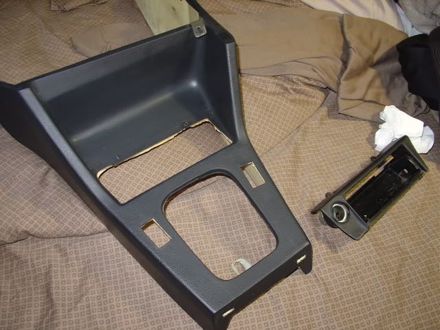

            I had to cut the console to fit the thing in. notice the part of the console that protrudes into the cupholder in my cardboard prototype? well its gone and i had no correct tools, so i ended up using a hecksaw with horrible results...
