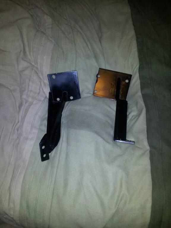

                              • navytapaul
                                • Oct 2011
                                • 615
                                #45
                                Sorry to resurrect an old thread, but got my mounts today and cant say enough good things. Otis worked with me to get them out in a hurry and shipped with a quickness. These things are sturdy too, no worry about breaking at all
                                Sent from my SAMSUNG-SGH-I727 using Tapatalk 2
