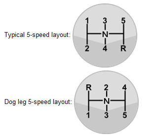

    I've hear the term dogleg, dogbox etc in the German car scene. Whare is the dog designation desribing? No sychros and straight cut gears rather than a traditional helical cut gear and brass synchros?

      Answer to my own question:
      A dog leg gearbox is a manual transmission layout with an up-over-up shift between first and second gear. The layout derives its name from a dog's hind leg, with its sharp angles.
      I guess is can be attractive to have the shift between 2-3 be in a stright line on some road courses.

        That and the gearing is different. The "dog" box has a 1-1 fifth gear and the regular one is 1-1 4th and 5th is an OD gear, .81 IIRC
