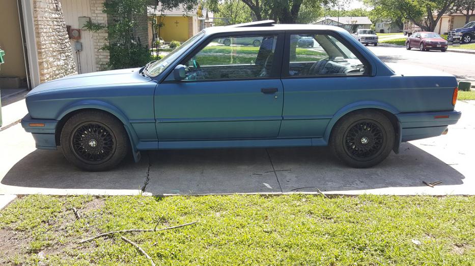

    #61
    ^our cars are almost twins!
    Koni Race
    GC 525f/600r
    Ebay camber/caster plates
    BBS rs 16x7/8 205/45
    Height: 12"f/11.75"r
      #62
      Rims???
      Originally posted by Nisse Järnet View Post
      Year: 1989
      Miles: ~150k
      Springs: Ground Control 450/650
      Struts/Shocks: Koni Race
      Front Height: ~12"
      Rear height: ~12"
      M3 E36 offset CABs, GC Camber plates up front and adjustable toe/camber in the rear.
      What rims are these??? They look awesome!
        #63
        You have PM :)
