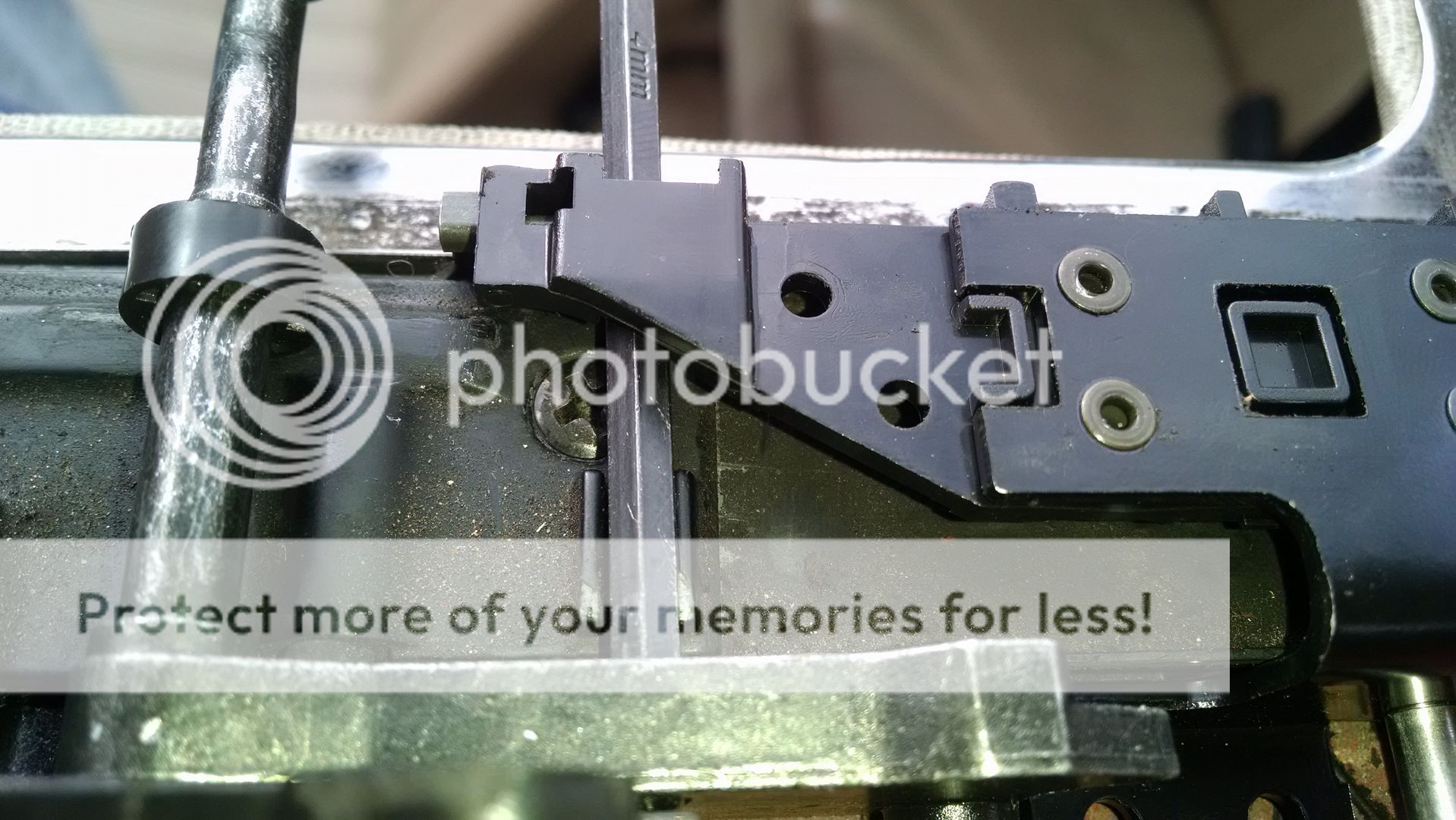

Next remove the 2 cable cover plates per side, you may have to move the sunroof to get at both screws for the rear plate
You can now pull the cables out

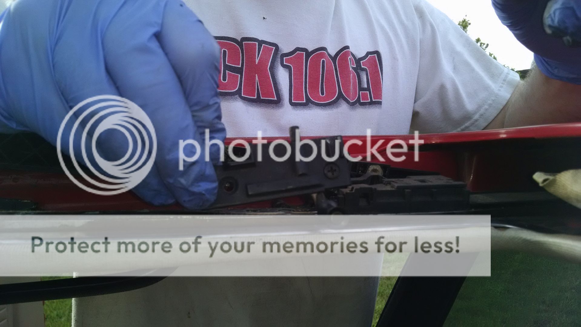

The rail will have to be transferred to the new cable. It took some force to remove but did not crack.
