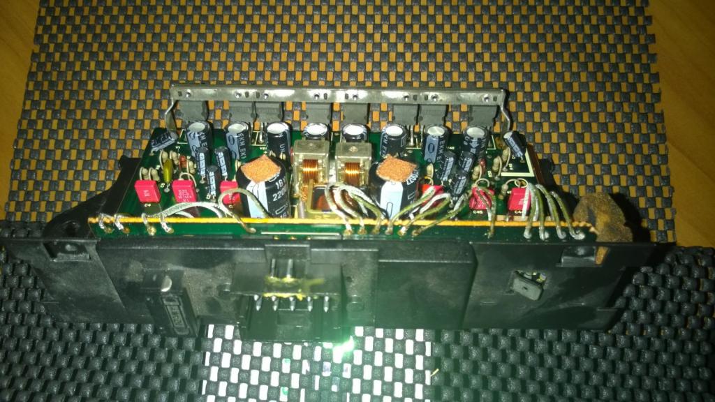

            looking at the back of the stock amp you can see a group of 4 wires together then a single solo wire , then a group of three wires.... after that it repeats the same grouping in reverse so then a group of 3 wires , then a single solo wire, then a group of 4 wires so 8 per pattern X's 2 patterns 16 total.
            Couldnt I find a way to just de-solder these leads and re-solder to a modern input plug to mate to a modern amp producing channels back in the loop to the stock harness and speakers?
            I would be upgrading the amp but keeping the circuit in the same closed loop pattern?

              Alright so I made it thru 15 pages of this monster 30 page thread pretty sure I got a handle on what needs to get done. I however what some advice before going any further , he he the reward is a super clean pic of the inside of a 27 year old stock amp blaupunkt I think these are and it looks like it should be working? idnk , there are no burn marks,no swollen capacitors, nothing melted etc just gave up I guess? SO thanks to a super kewl RV3 dude I have another stock amp coming in the mail and that should be a good temporary band aid while I sort out the next step, just couldnt go without music on the morning drive anymore and I really dont wnat to hear the brake limiter noises telling me to work on that gees whats more important here LOL
              the ride is a 1987 325 is she has the front tweeter pods, has a working fader, had a working trunk amp, the PO installed a JVC head unit the rear speakers are orginal the rectangle shape with the raised angled seperated horn. Okay so the JVC head unit was playing clean and loudly with the stock premium system, working fader amp etc. The amp has died I am pretty sure the front tweeter pods were still working because the music was pretty loud, umm cant remember what is in the kick panel under the front dash, hope I am not missing anything for a good diagnosis Paging DR. Luke
              So it seems like with an aftermarket head unit already installed, speaker sound good, fader working, and most everything at hand in good shape I have an easier task but here is my question... sorry in advance for this thread clogging size post
              Thanks much :grin: S
              So, I don't understand why you would care if that stock amp plug gets cut off or not, seems a damn silly thing to worry about, especially since someone hacked the front to put a JVC in.
              You could unsolder the plug and solder wires on...or just crimp little pins on those same wires and plug each one in. I guess if you have a spare amp lying around, but sure seems like a buttload of hassle for nothing.
              Oh BTW: using speaker level signal for an amplifier input is pure hack when you have an aftermarket deck and an aftermarket amp. Get off your ass and run some fucking RCAs. (exception: if you own one of those Alpine KTP445, use high level because you bought a shitball amplifier) Use that stock harness (seriously, why would you care if it's hacked? Resale?) for speaker wires, but to use it with an aftermarket deck as an amp input is just horrid. (again, unless you bought that turd of an Alpine)
              As far as that stock plug pinout sequence, its not that complex. You have 4 positive inputs, 2 negative signal grounds (chassis ground on all BMWs BTW) 4 pairs of speaker wires, power, ground and remote. It's nothing unusual, just 4 pairs of speaker wires with inputs and power, like any other little POS stock amp in pretty much any car so equipped.
