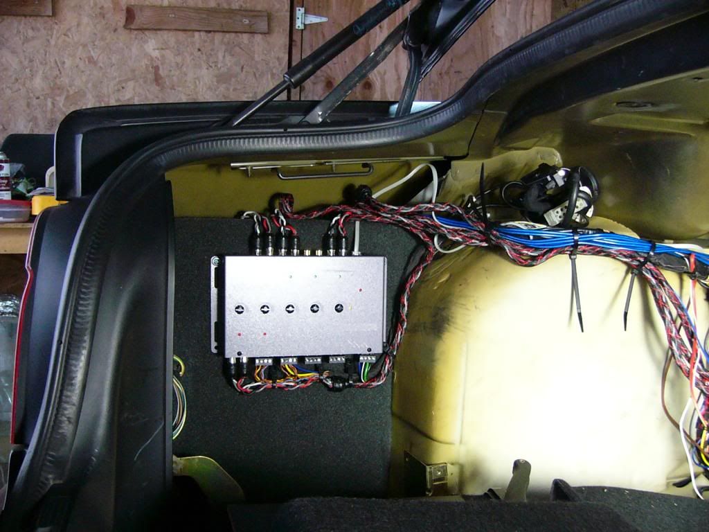

Third method is much more expensive and significantly harder to set up, but offers drastically better performance, and that is an "Active" LOC such as the JL Audio "Cleansweep" or the Audiocontrol "LC" (LC2, LC6, LC7, LC8)series.
Her is an LC8iinstalled in an E39:
There are several o the market, most are well over $200 and all do a great job of making a stock deck interface with aftermarket amps. Most offer the advantage of making a subwoofer output for you, some include a sub level control as well, but choosing a correct amplifier for your needs will get around that issue as well.
