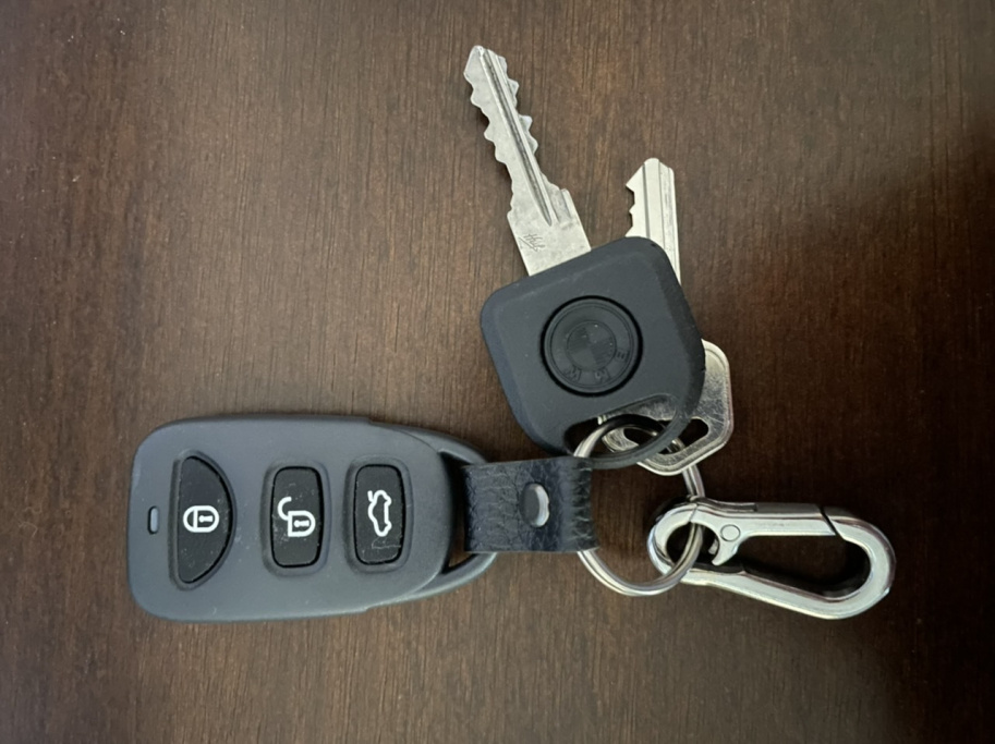

          *** Just wanted to note, I first attempted to install the kit in the trunk, and I was going to pick up the side marker wires for my signal lightning, but I had issues getting the unlock signal to work for some reason. It could have been that I was trying to test it with sub par temporary connections, or my main concern was I was getting a bit of voltage drop going to and from the dinky keyless box being that I was a few connections away from the actual locking system. In any event, having the keyless box up front worked better for me and it’s very accessible if I want to ad more triggers to the system as it has provisions for a trunk actuation, siren and an led indicator. There is also a recoding button for the remotes.***
          Tucked away yet accessible…
          Click image for larger version  Name:	CE685EBE-A4F6-4AF4-AF15-8B193AA43963.jpg Views:	0 Size:	197.9 KB ID:	10088013
          The two provided remotes feel solid enough, and I was able to walk 150 plus feet away from the car and still trigger the system locked and unlocked. I didn’t go any further because my car was in the garage and that’s as far as I could get and still see the lights blinking…
          Click image for larger version  Name:	73F83C5A-DE9D-4EF7-8159-533209CD945B.jpg Views:	0 Size:	193.6 KB ID:	10088012
