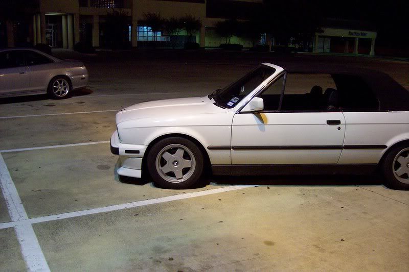

                          h&r sports
                            Originally posted by jw 325ic View Post
                            h&r sports
                            What shocks? and what lip spoiler is that?
                            WTB-Strut Bar
                              billy sports. reiger infinity replica lip. whats with your sig? 93 with DB up front?
