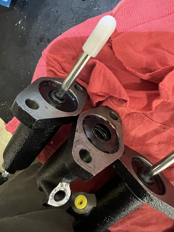

    Looks like I need this throw out bearing - https://shop.bmw.ca/p/Bmw__/CLUTCH-R...511204525.html
    Think I could get away with extending the rod to match the distance between the late model TOB? It isnt much and I would wayyy rather do that vs taking off my headers/exhaust and dropping the transmission if I can avoid it.

      Presumably it is possible to extend if you have the parts/means

        I appreciate all the input on my clutch issues. I couldn't see any issues with my installation, so I made a new rod that was 1cm longer and it now works great. Still cant get the setup to stop squeaking. Anyone solved this issue before?

          #64
          Last photo shows the condition of the over-exerted clutch slave cylinder
