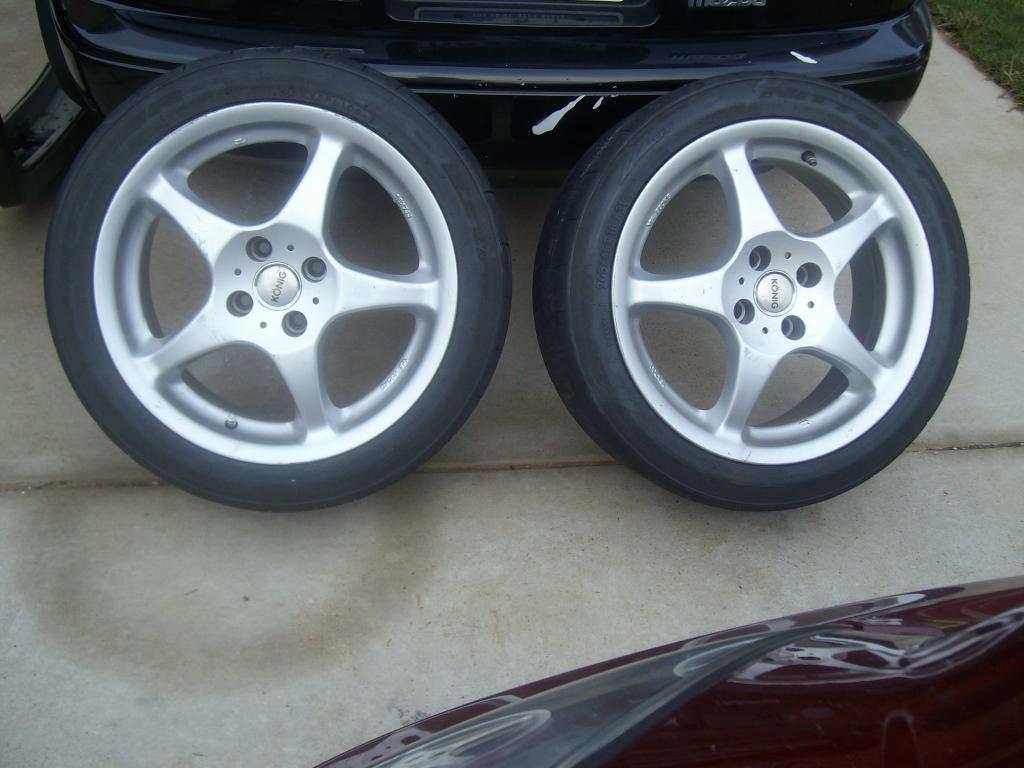

            momo mirage 16x7.5 et35 (for sale, asking $175)

                Hey do your momo's come tires? or just the wheel? are you going to bring them to the picnic I would like to see them in person.
                    they dont come with tires. i will definitely bring them to the picnic so i can get rid of them.
                        I might buy them if I have enough cash.
                            well bring $175 and they're yours.
