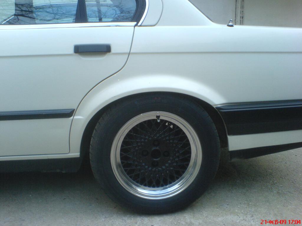

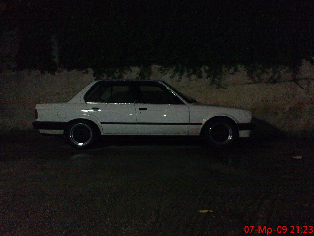

                    Well after the opinions of the members of the Forum here is the final stage of the car. I put 15X7 et12 wheels with 205/55/15 Continental Premium Contact2. I have lowered the car with 4cm APEX springs for 6cylinder BMWs. My car is 4cylinder so the final lower is smaller. However i had to roll the rear fenders, because with 4 passengers it was horrible. Maybe i should had put 205/50/15.:( Thanks all the members and especially Mystical.
