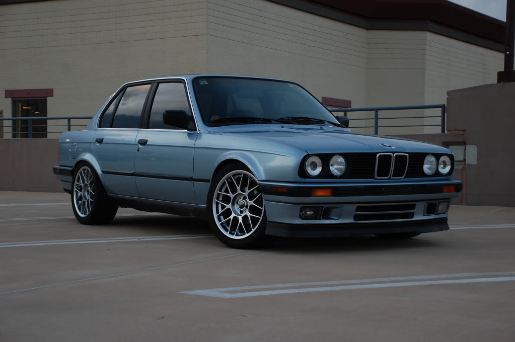

          depends on what you think fairly high is i guess...
          this ride height sits nice with me and these are 17x8 et 25 with 235/40/17. so a 235/45 should work on a +25 as well as rolling? and i have a old model rear arches...
                    [ATTACH]84411[/ATTACH]
                    As for the fronts I'll do the same sizes and just accept the SLR longer LCA's will stuff everything up haha.
                    Thanks!
                    Yes, I know the offset of the ARC-8s well. Who do you think they asked when it was time to create them 5 years back? ;)
                    I'm not 100% on the 235/45 rear fitment as it's ungodly tall for an E30. With high rear arches, a fender roller, and adjustable ride height I'm sure you can get it to work though.
