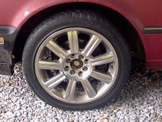

I have 16x7's and they are wrapped in a 205/45/16. There is also a 3mm spacer to keep it off the strut in the front. I would like to go to a 205/50/16, will everything stay the same because I want some more meatz :)
Here is a pic, I am going to paint them a metallic anthracite grey I think, I don't like chrome a lot just personal preference. And I have no idea what the are I took the centers out they were hideous.
I would also like to add my car has not been lowered but I do plan to do so. I think with these wheels I will have to roll the rear fenders because they are going to touch. And is it possible to maybe run a 225 50 on the rear for a stance? It seems the 225 tire is around .60 taller.Last edited by Bullhead; 09-16-2014, 04:36 AM.sigpic87 325E The Honey Badger

Originally posted by Bullhead View PostI have 16x7's and they are wrapped in a 205/45/16. There is also a 3mm spacer to keep it off the strut in the front. I would like to go to a 205/50/16, will everything stay the same because I want some more meatz :)
To fit them properly you need $200 worth of spacers and bolts. Just use that money towards wheels that fit and don't look like that. :)

What setup would you all recommend with a 225 50 16 tire. I was thinking of going 205/50/16 in the front and 225/50/16 in the back because I can get the same brand and style tie but it looks like the 225 is 3/4" taller and idk how this would look. I have a stock suspension now but plan on doing a lowered stance but not slammed. I would like at least 1 - 1 1/2"s of fender gap and the ability for my shocks to travel. I would also like to run the 50 series sidewalls if I can on the 16's, I like a little meat on my tires. I am already in the process of finding fender roller I can use so the lips will be tucked. I am running a small 5mm spacer and with a 205/50/16 this puts me about 0.5"s from the strut right now. I will have to measure my offset but it's a standard Honda type "uni" wheel I'm sure.sigpic87 325E The Honey Badger
