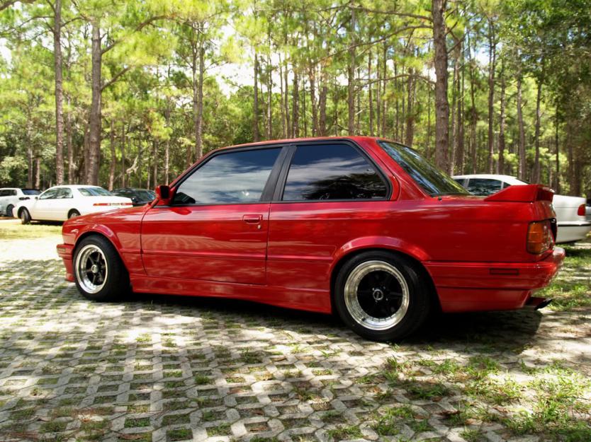

    I am going for a particular look with my wheels and I dont know much about offset so bear with me. I love the look of this car, but the wheels up front are a little wide for my taste. I want to go with a 15x7/8 staggered offset. These rears are perfect in terms of fitting out the rear quarters, but if I went with a 7" up front should I keep the same ET15 offset to bring the wheels in a little closer under the front fenders? My car is currently slamemd on vogtland(?) lowering springs and Im hoping I wont have to roll the fenders and im hoping there wont be any rubbing issues up front with a 15x7 ET15?
    This picture says the set up is 501: (15x8, ET 15, 205/50/15)
    Also, I think the 205/50/15's look perfect on the rear, but what tire size would i want on the front 15x7's to match?
    Thanks
              Thanks
              Yep, 15x7 with the same offset is exactly what you want. I'd use 195/50 tires.
