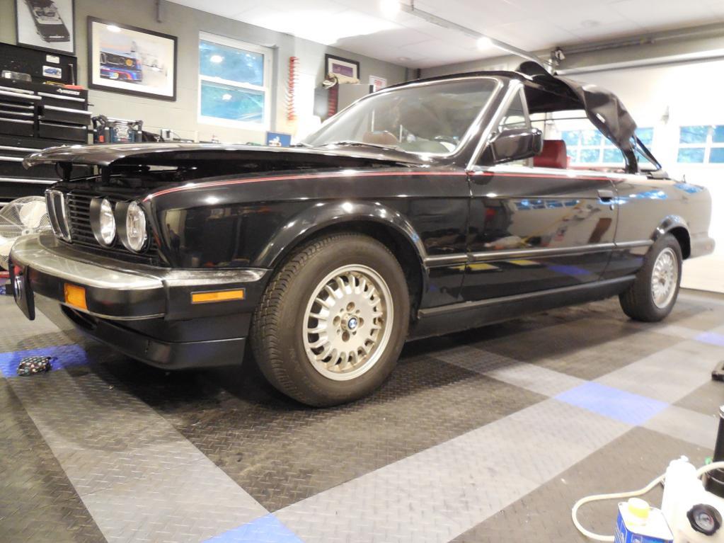

          Thanks for the info, but I think I've moved to another option. Again, E30 cabrio, KYB and H&R Sports. She sits a bit lower in the 2nd pic, since the springs have settled.
          ESM-009 16x7.5 ET18 4x100 CB57.1 Lip Size 3.0" Gun Metal/Polished Lip - Front
          ESM-009 16x9 ET15 4x100 CB57.1 Lip Size 4.0" Gun Metal/Polished Lip - Rear
          Any fitment issues here? Tire sizes with no stretch, and little to no speedo errors?

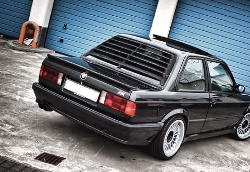

                  89 325is tire size??? Mystical i have set of staggered wheels 15x7 front and 15x8 back et 12...what tire size can i use? currently im running 15x8 front and back et 20 with 225/45/15 all around h&r sport springs an blisteins sport ( i dont like my current wheels tho) with no problems i believe the fenders are slightly rolled....what tires can i used? thanks in advance...the bottom pic are the wheels in question...not my car tho!
