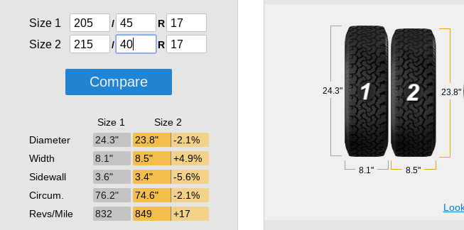

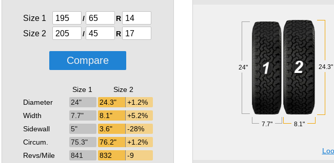

            Need some info on what tires/rims to run. I am using the nasieg 5 lug kit which pushes the front out by 12.5mm and e30m3 stock offset in rear with 12.5mm spacer.
            I am looking for tires in 205/45r17 or 215/40r17 and have access to a 17x8 Borbet type T or 17x7.5 MContours (2 are reps).
            I have the Borbets on now and dont like how they handle and I have rub issues with the 225/45r17s on the car right now.
            1. Should I run the 17x7.5 Mcontours? Will that improve handling?
            2. Can I safely fit a 205/45 on the 17x8?
            3. Which tire can I run without rolling fenders? I'd like to be able to run the wheel liners and fog ducts/plates.
            4. Looking at these two tires, on a budget, opinions? I just need an everyday all season tire that can handle the occasional spirited driving and will wear well. I will run winter tires December - April.
            a. 205/45r17 General AS-05
            b. 215/40r17 Nitto Neogen
            5. Can I run a 84 load rating? I will be traveling cross country with all my ski gear and a lot of weight in the car. I know the stock load rating is 89.
            Thanks!
            Pics for comparison:
            Stock vs 215/40
            https://www.r3vlimited.com/board/att...8&d=1538003330
            Stock vs 205/45
            https://www.r3vlimited.com/board/att...7&d=1538003318
            205/45 vs 215/40
            https://www.r3vlimited.com/board/att...6&d=1538003305
