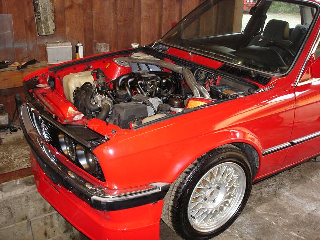

      is def. pos. my car was a 318i M10 now its a 2.5
      fit in there just fine. was a bit of work.

                Mike Elder. You bastard. I love your car (red one in this particular case). That is all.
                Mariano
