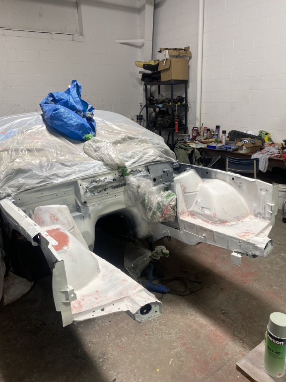

      Driver side got a coat of primer to see any imperfections since it was 16 different colours
      A little bit of primer goes a long way!

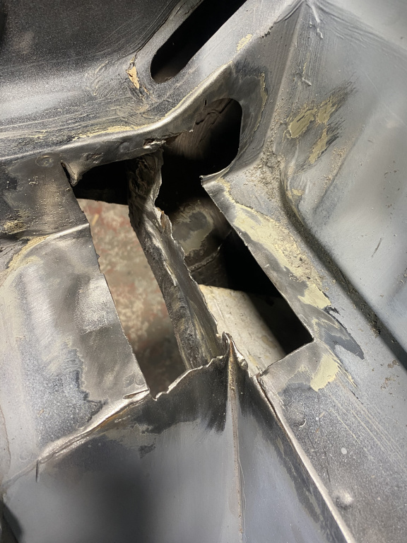

          So..... I've been avoiding this spot since day one
          There was a small rust hole, and I previously glued in a piece of metal with JBWeld while I redid the rest of the car
          knowing it would be temporary and Id take care of it properly once I got in the engine bay repairs
          I hit this area with the wire wheel in the wheel well, and it just grew to the point where I had to cut it all out
          The part that stresses me the most is the other side of that hole in the back is inside the car behind the dash
          I have access to it, but It will be very sketchy to weld without removing the dash.. I guess I will find out this week how that goes!
          Wish me luck

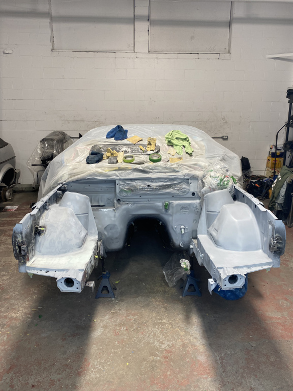

            After hours of finding imperfections, finishing putty, sanding, and repeat
            I finally was able to hit the engine bay with a thick coat of high build primer
            Besides that one corner I need to address, overall it's looking pretty ready for paint!
              If you can, get a bigger piece of aluminum or copper on the dash side. Can hold it in place with strong magnets. It helps to block some of the hot bits from coming through. Just did this last weekend when welding into the trunk from the rear wheel tub.
              Try to have someone on fire watch if possible.
              And keep water & fire extinguisher BESIDE you while welding.

                  Welded that piece in without lighting the car on fire! Lots of precautions were taken and definitely stressed about it the entire time
                  but we made it through!! Happy that I was able to cut out most of the badly rusted areas on the car now!

                      Final prep before paint this weekend!
                          1989 BMW ​325i - M54B30 Swap in Progress
                          IG : e30rossi
                          Montreal, Canada
                            Seeing this made the last 3 months of work all worth it! So stoked on how it looks
                            Also painted the rad support, ready to go back on !

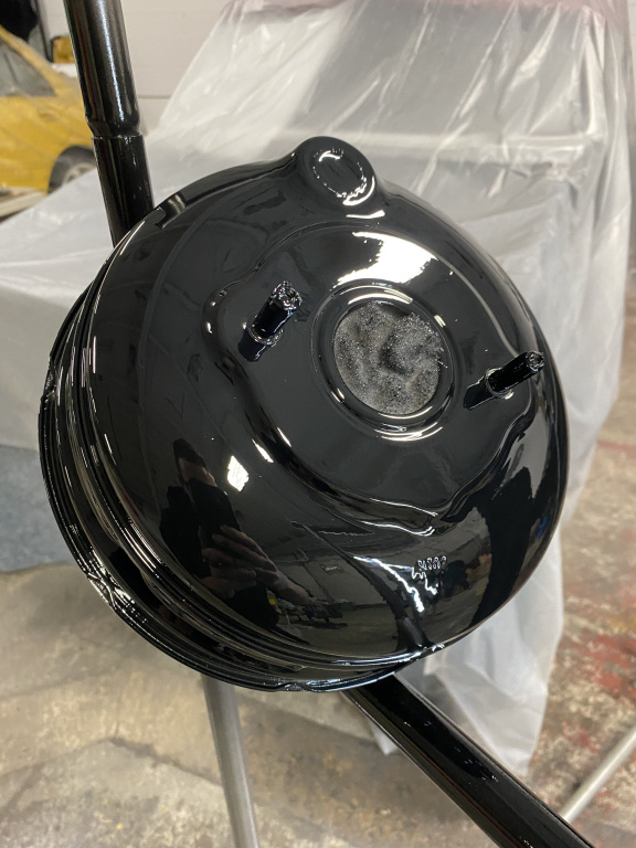

                            Blower motor cover got a coat, going to blend in super well!
                            Last but not least, booster will look so much better colour match vs. the aluminum x3 finish
