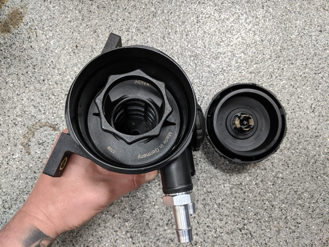

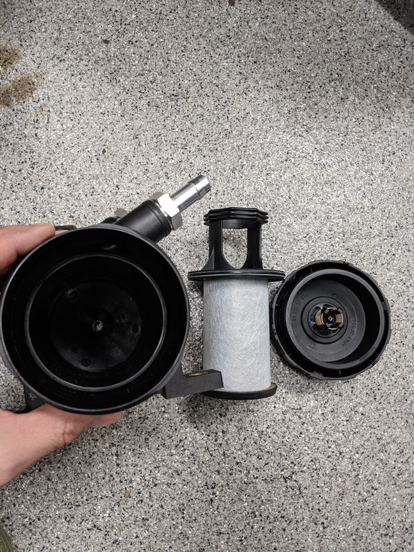

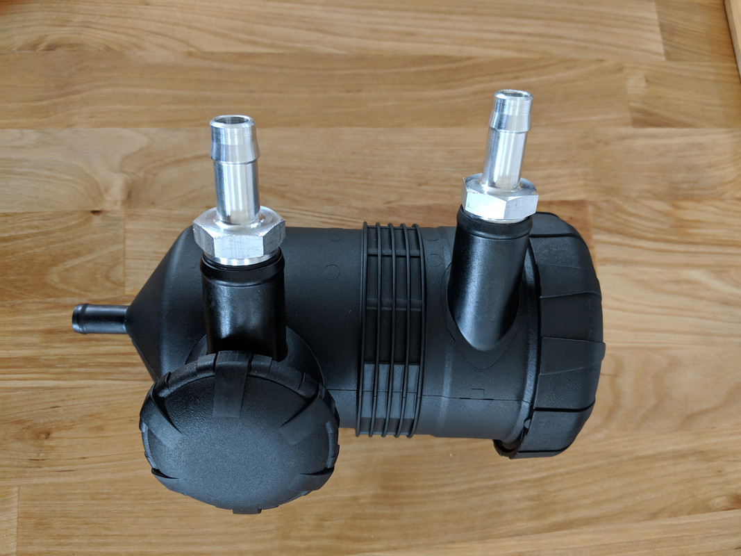

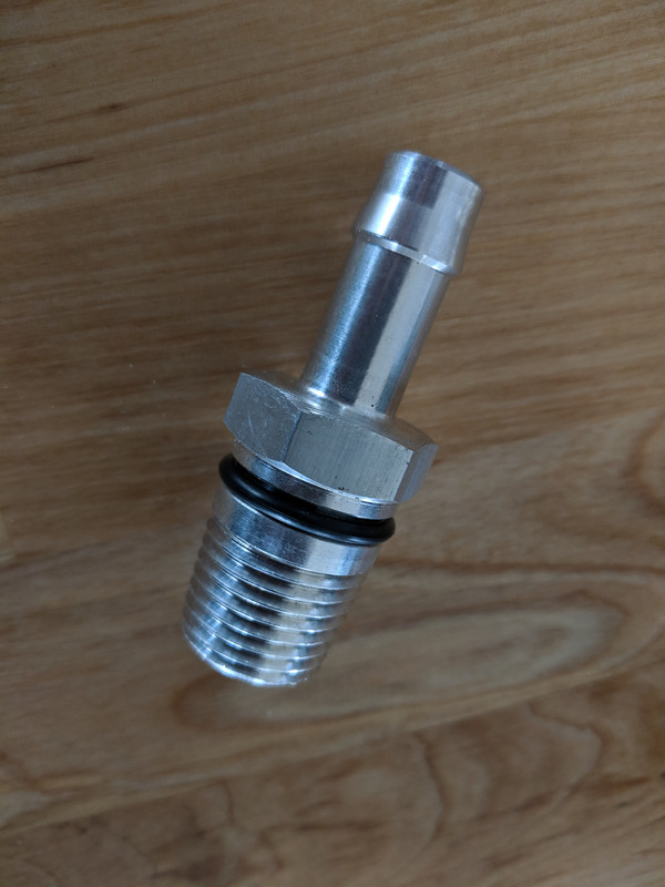

    I plan to run a PCV system on this motor. After searching around for a bit, it seems most of the aftermarket PCV filter/catch can systems aren't really setup to operate as a PCV should. I finally stumbled across the Mann Hummel ProVent 200. It's an OEM quality part with by-pass valve integrated into the cap, replaceable filter media, and a crank case pressure regulator valve. The one issue was that the inlet/outlet are huge (~1"). I ended up finding a company out of Australia that makes thread-in adapters with o-ring gaskets specifically for necking down the ports on this unit. They fit perfectly.
    Now I just need to pick a final spot and make a bracket. I plan to order a secondary catch can that I will route the bottom drain to just in case the amount of oil bypass is of any significant volume.

        Ahh those crafty Australians, the provent 200 is a really good bit of kit. They are almost a none negotiable to fit in common rail diesels to mitigate carbon buildup.
