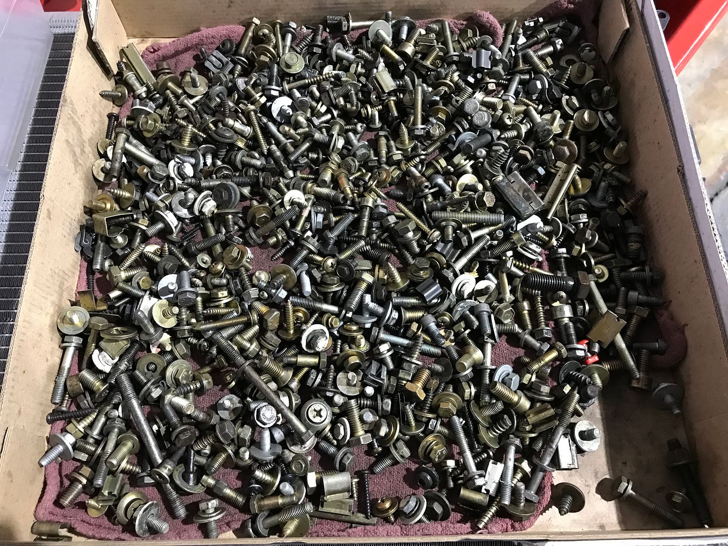

                  This past Saturday I spent a half day at the shop blasting hardware. I've moved through pretty much all the hardware, leaving just bolts and screws with 10mm heads or smaller left to do. I know this looks like a lot of parts, but this is all thats left and the majority of it is behind me. I'm glad to have a light at the end of this tunnel.
