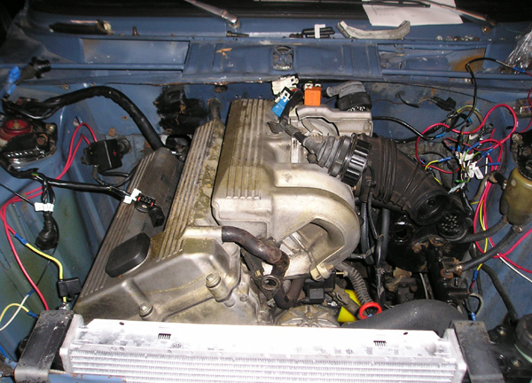

Over the past two weeks I have been installing a m42 in my 2002.
I am using a e30 m42 with the e30 trans. I will run a electric speedo. But this trans can run a mechanical speedo if you swap the back section with a 240 from a e21.
I am waiting on a few things so I will be at a stand still for a couple weeks I think. But it should be running and driving by the end/middle of January. And then it will sit in storage until it gets warm out and I will finish some things.
Here are a few pictures...
