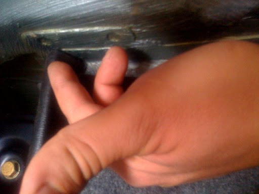

    Pretty straight forward with a few exceptions. The biggest deal is where to drill the holes at for the bumpers. If you use the stock holes from the old shocks, they dont line up and if it comes close, the bumper will be sagging way down away from where the body lines tell you it needs to be. Take out the carpet in your trunk, look down by the trunks floor pans and near the tail lights.
    You'll see what looks like a reinforcement tab with 2 dimples in it. It will be epoxied over by the factory.
    Figure out which hole you'll need with the brackets in hand, and drill through that dimple. I promise you, it will come out perfectly so that you are using 1 end on the existing bumper shock hole and the one that you drilled. Thats where they made the difference between the euro chassis and American versions.
    Put the largest diameter bolt end on the bracket into the existing hole for the American bumper shock, and the other smaller diameter bolt on the bracket into the hole you drilled. You'll angle the bracket upright and a little to the side. Like this:
    Another trick I noticed, is to keep the nut loose that bolts the bracket to the bumpers. This is so you can adjust it how you need to when aligning the bumper. You can slide a socket and ratchet in just fine even with the bumpers mounted. Everything else bolts up in the original American holes on the sides.
