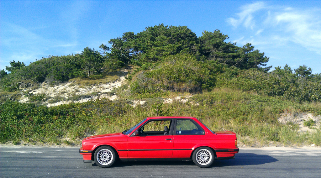

    2011-2012 Project: Get an S54 running in an E30 using a stock MSS54 DME
    Picture taken August 2012 of completed swap.
    This thread documents the installation of an S54B32 into an E30 318is.
