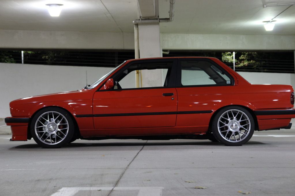

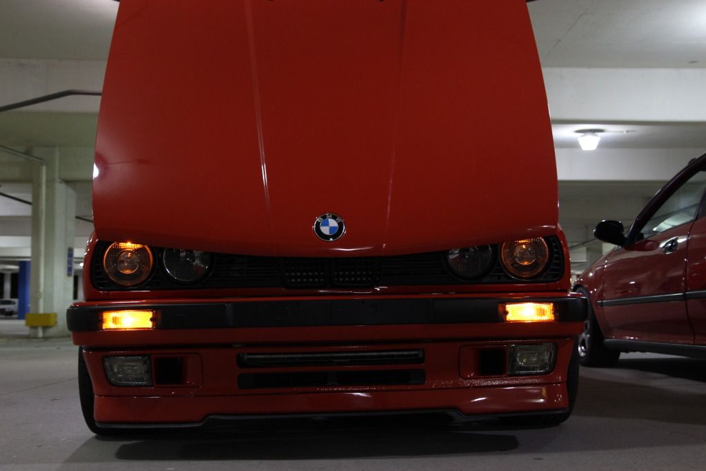

    The time has come to sell my baby. A lot of time and money was spent on this car to make it what it is today, but purchasing a house takes precedence and selling the bmw will help finance it. Things change, and family becomes a factor. Anyways, about the car. It started its life in 1989 as a 325i, with the 2.5 inline six mated to an automatic transmission. Exterior color was zinno, with black comfort interior. I purchased it in 2008 from a nice lady completely stock with about 150,000 miles on it. She had taken really good care of it and had a large stack of receipts of work performed on the car.
    Now to the fun part. I’ve worked on/changed/rebuilt/replaced almost every part on this car to make it more reliable, fast, or visually appealing.

    The car made 440 whp and 415 wtq at 18 psi the last time I went to dyno it. This is with a slight misfire in the upper rpms because the car needed cooler spark plugs. I have since installed colder plugs and have had the car at 22psi on the street (estimated 500whp). **Disclaimer: The car is very fast and potentially dangerous, and on the current tires it will spin through the first three gears no problem. The car will be sold with the boost controller off and running off the wastegate spring (11-12 psi). You can turn it up as much as you want at your own discretion with the turn of a knob once you are comfortable with controlling the car. Running off the wastegate is still fast (~300whp), but it is very drivable.
    That’s about it. Sorry for the lengthy ad, but I wanted everything to be put on the table the good and bad. I probably missed a couple points because I wrote this based off memory, so I will update as I remember things. The car has been very reliable for me and never left me stranded on the road. I have driven it roundtrip to car meets and shows all over the east coast. I have driven it 7-800 miles in a single day with no hiccups and still got 25+mpgs! Most parts where purchased brand new, no cheap/fake/replica/ebay junk. Most of the turbo items (turbo, cam, clutch, engine parts, exhaust) have less than 10,000 miles. Tires have about 2000 miles on them, and the wheels are clean. Iam asking __11.5k__ for the car. I think this is a very fair price after researching what other stock and modded e30’s go for. Iam more than willing to work out a deal with you, and would be willing to do a partial trade for a stockish e30 or similar car plus cash. Make me an offer, the worst I can say is a polite no. I have a lot of time and money in this car, and by no means do I have to or am forced to sell it, so please be reasonable. Any questions, clarifications or picture requests can be emailed to me e30psi@aol.com. Iam located in Northern Virginia, and willing to work with the buyer to ship the car. Viewing/test-drives can be scheduled any day of the week for serious buyers with a cash offer in hand. Thanks!
    dyno run video:
    highway pull. this is my old turbo setup (smaller turbo, less boost, stock engine internals) car had about 300 wheel:
    pictures from last week:
