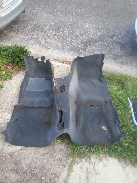

    Goal: to vacuum and dye this carpet from blue to black and put down a sound/heat barrier and audio insulation under the carpet.
    Dirty carpet pulled. Took over 4 hrs.
    Ready to be shopvac'd

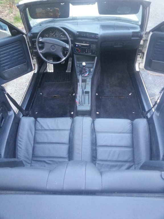

    Barrier. Frostking, which can be purchased at any Lowes or Home Depot. It is originally designed for insulating HVAC systems but is a great Dynamat alternative. Its cheaper $20 a roll. Its lighter, and it is easier to apply.
    Majority of stains removed. I didn't focus too much on where the seat is because you won't be able to see that.
    Successfully dyed with Rits and a spray bottle. Let dry for 6 hrs.
    Interior cleaned and degreased. Ready for barrier.
    Passenger side done with about 1.5 rolls.
    Driver side done. Used about 3 rolls total. Could have bought more since I plan to do the trunk as well but I covered everything so no problems.
    One of the reason I did this is because the unbearable New Orleans heat. Most of the heat in my car came from the engine/transmission bay so insulating these areas well makes the car like an ice chest with the A/C running at the minimum setting.
    Carpet back in.
    I'm happy with how it came out.

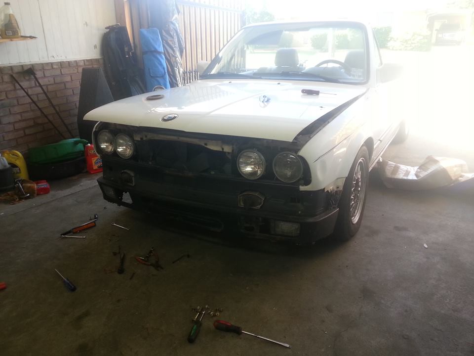

    Goal: swap my metal "diving board" fit plastic euro bumpers.
    Lower valence fitting. Little too messed up for my liking. But grinded the tow hooks to fit the bumper and installed the shorter shocks.
    Front bumper successfully test fitted.

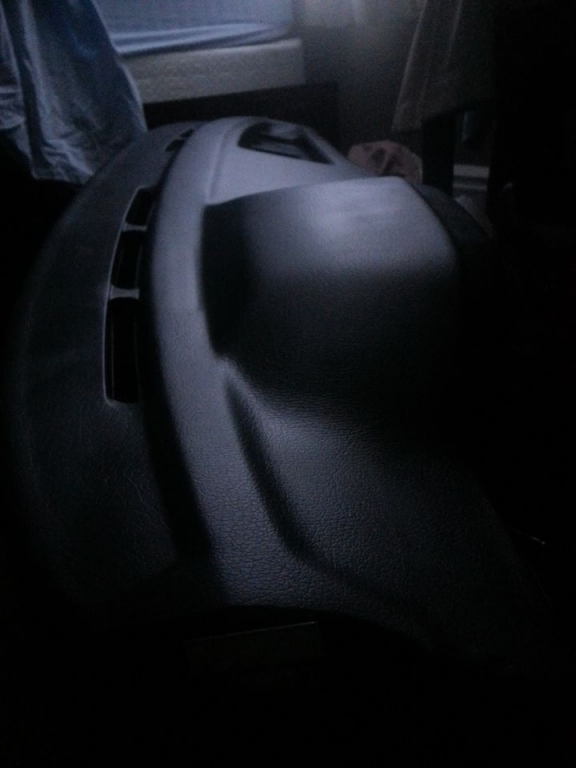

    Bought new crack free dash for $40. The guy said either he really didn't know the price of BMW parts or I was the best negotiator in the world.
    I'd say a little of both.
    Picked up a euro valence and smileys from the same guy $300 package deal. Beautiful condition.

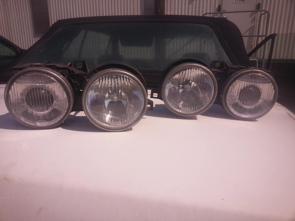

    Old boring bs projector headlights
    New headlight plugs to fit the smileys
    Before and after. Will really pop once my hid's come in

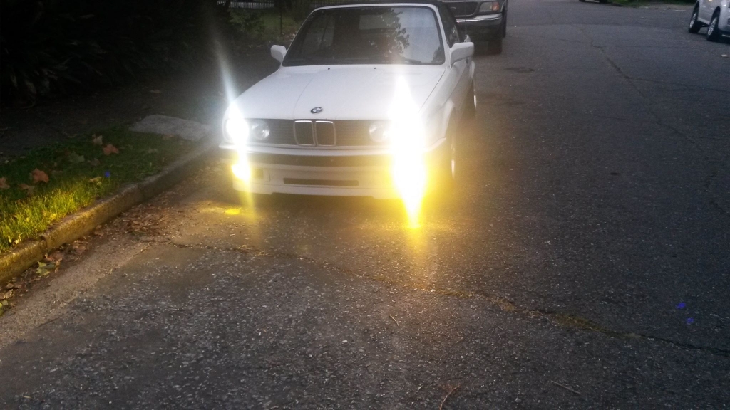

    Loving these HIDs. 35W Apexcone 5000k from DDM Tuning.

    And God said let there be 3000kHIDfoglight
    and it was good

        Ah man, that guy ripped me off too on some centercaps. How's the difference with the insulation you added to the floor? Did you have any problems fitting the carpet over it?
        January 2012 COTM
        • departeg
          • May 2012
          • 105
          Don't get me started on the centercaps...The insulation was worth it honestly. I set my A/C on the lowest setting for a couple minutes and it stays cool usually for the rest of the ride. The downside I think is it may trap the heat as well so I'm going to get some ceramic tint to keep it cool and keep my new dash from cracking. The carpet took some working to get back in place but it really isn't that thick. The biggest difference is the sound proofing. I have straight pipes and a vert so I wanted atleast one sound deadening element for the cabin and i'd say its close to 30-40% difference.
