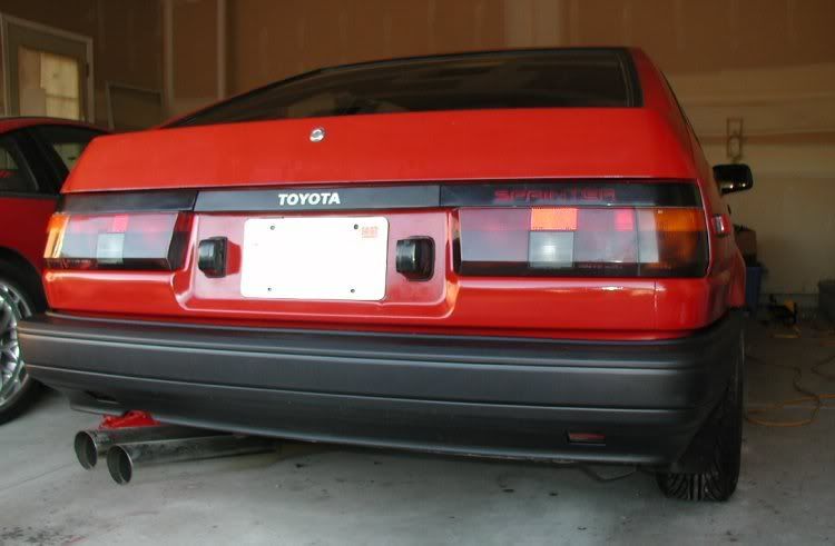

First off, get a can of tremclad real orange (or what ever color u want) in the can, not spray, yes tremclad, it is a acrylic/enamel paint which is very durable. next prep your car as if was any other paint job, fix all the rust, ect....no need to prime the car since the tremclad allready contains elements which allow it to be painted over bare metal. next, after prepping the car get a small 4" professional FOAM rollers, it's tiny and has one end rounded off, and the other cut straight, and is a very high density foam. u also need a jug of mineral spirits to thin the paint. The thing i really like about this is that there's no mess, no tapeing the whole car, just key areas, and u can do it in your garage, since your not spraying there is virtually no dust in the air, just clean your garage first, also it does'nt really smell at all, dries overnight and it super tough paint. also it you decide to paint the car professionally later, just prep and paint, there's no need to strip the tremclad. i have done this to a few cars, and i can say it works amazing, u just have to be paitient. next u thin the paint with mineral spirits so it just about as thin as water, a little thicker. get out the roller and paint away, don't get the paint shaked when u buy it, enamel is stirred, otherwise you'll have bubbles in the paint for a week!!! after u do 2 coats, wet sand the whole car, then repeat, 2 coats, wetsand, 2 coats wetsand. i painted the charger using a can since your not spraying the car u use all the paint and not spray 50% in the air, use progressivly finer sand paper each time. it's not really that much work, cause u can stop and start any time, u can do just a door, or the hood, ect. do one panel at a time, and don't stop once you start. once your done the final coat, wetsand with about 1000 grit to a totally smooth finish, and then using a high speed polisher i use a buffing bonnet and turtle wax polishing compound. do the whole car with this, and i'm telling u, depending on the amount of time and paitence you have, the results are amazing. laugh if you want, but for $50 ($30 for paint, about $20 for rollers, sand paper, ect...) it really looks good. also you can do these steps overnight, paint one evening and by morning u can wet sand. i have personally done alot of painting, mostly single stage acrylic enamel, and i've sprayed several cars in my garage with really good professional results, just it stinks, it's a real pain to do, easy to make a mistake, messy, and expensive. The tremclad is awesome paint, the "real orange" is an amazing hemi orange, and almost looks like it has some perl in the sun, awesome color right out of the can.
here are some finished results
