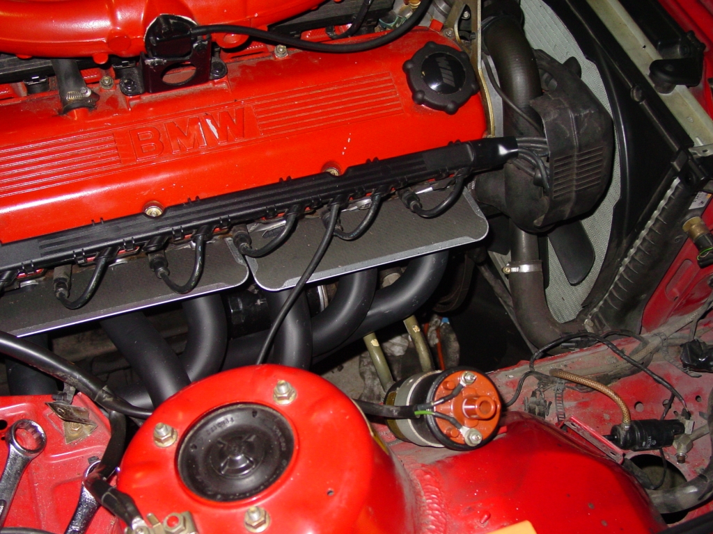

    Well After about 6 months from the cock tease thread my car is finally back on the road... barley
    had to fix a heatercore leak and clean the carpet, plus put in the M seats and street bar so... interior had to go.
    While the interior was out James was nice enough to wire the car, removing the things i didnt want (OBC harness's, Cruise Control plus fix the mistakes the Previous owner made on the Audio).
    The E36 M3 seat (non vader) i dont like the look of vaders in the E30. these look more at home.
    Today was another big step as i began the welding of the roll cage, accually James's dad joe did all the real work, i just helped
    I know it is just tacked in... im going to re-enforce the bottom then bolt it in again, then joe is going to lay a good bead.
    and finally the E36 rack is in and converted to Non-Power steering
    The freshly ceramiced headers are now in too. there is a CAT but it should be deleted soon for a standered midpipe very soon.
    ill update more soon.

    looks good, do you plan to take the paint off the BMW on the valve cover. It looks like some has come off....

        Yea the valve cover will be switched, it will be black with red lettering and the red manifold will have black...
