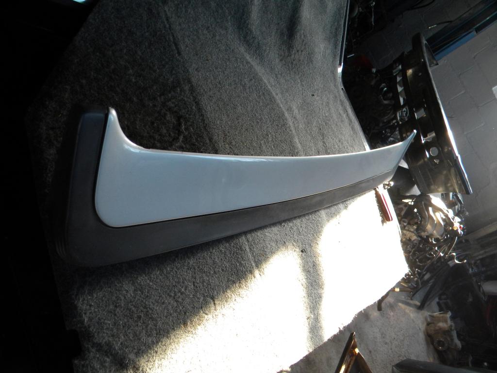

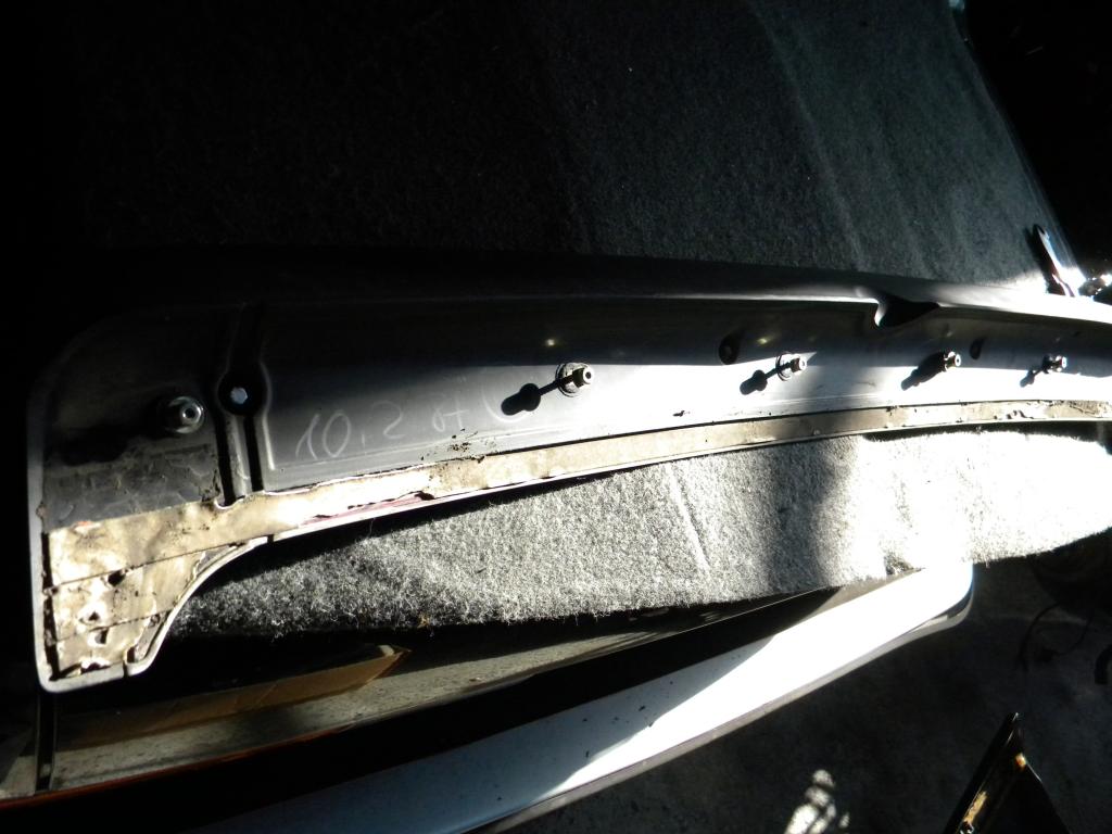

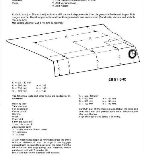

Installed one of these on my car a while ago. Fits nicely once fastened down properly. Your best bet is to drill holes through the metal seal on the underside of the trunk where the outer mounting points line up. I used a stepped bit for this. They need to be just wide enough to fit a socket so you can fasten down the bolts. Double stick tape on the front and sides of the spoiler, paint and RTV or some form of sealant wherever you drilled, and you're good to go.

Her's my installed e28 M-Tech wing, no template used due to the fact that I had my buddy at a body shop fit it and then drill the holes to make it flush with the trunk.
