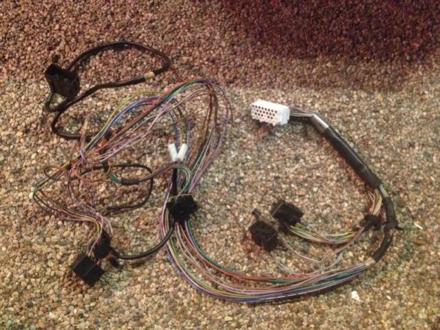

    Well i believe it is that. LOL. Got it in my car when i bought the car.
    Who ever knows please comment. The part number says its a dashboard cable harness.
    Asking $30 but i have no idea what its worth. If its more or less we can work a deal. No cut wires.

        Can't really tell by those pics. Can you post up a pic of the connector connector hat plugs into the OBC? I could tell you then.

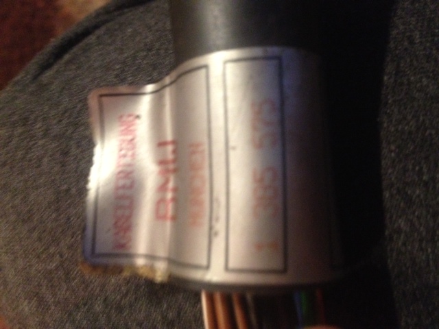

          I will when I get home. But the part number is 1 385 575. Is that any help?

              its not a obc harness i think. the plus is rectangular and has a bunch of circles in the plug

                It is the harness that runs behind the dash (61 11 1 385 575) and here's the breakdown starting from right to left:
                -The white connector is the female side of C103.
                -The black nine pin connector goes to the headlight switch.
                -The black two pin connector goes to the fog light switch.
                -The light goes to the light switch panel for back lighting.
                -The next two black connectors go to the defrost and hazard switches.
                -The four female spade connectors go to the glove box light switch and light.
                -The black two pin connector is the glove box charging receptacle.
