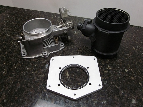

    For sale: 3.5" throttle body & CNC machined adapter plate & 3.5" MAF.
    TB and MAF are from a 540......adapter plate is custom made. (3" diameter opening, plate is 3/8" thick)
    $350 plus shipping
    The 3.5" TB/MAF setup......along with a CAI, cams, injectors, and chip......and you are well on your way to BIG SMILES.
    I have several of these available.
    NOTE: Once you bolt the plate itself to your existing intake manifold it acts as a jig to allow you to easily and accurately dremel the existing 2.75" diameter opening out to a full 3".

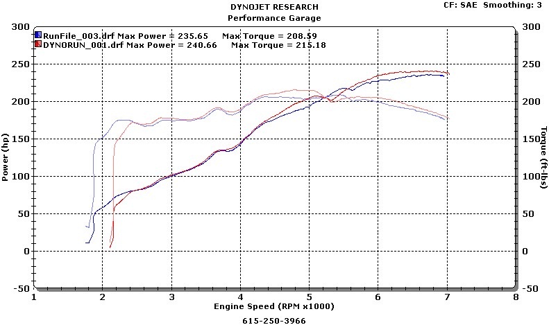

    Attached for shits & giggles is a Dyno sheet of the Dakar S50 in the video below. Car has CAI, injectors, headers, Turner chip......as well as the 3.5" MAF/TB setup. Stock S50 is about 200 to 210 WHP if I remember correctly.

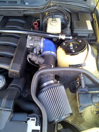

    Any pictures of this installed?

                    Pic posted of TB/adapter/MAF installed in a buddy of mine's car. I am in the process of dropping a S50 into an E30 track car and will be going this route as well. Besides more airflow the sound is frickin' awesome!

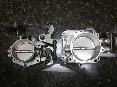

                              I don't think the bimmerworld/mishimoto boots will stretch enough to fit over the 540 TB. The stock E36 TB is 64mm IIRC, if the 540 TB is 75mm so I doubt the nice silicone boot with the ports will work.
