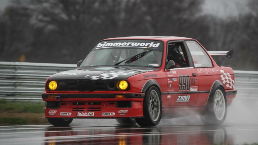

Regular flares installed on my track car
Kamotors Rivet on Fender flares.
