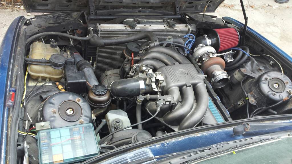

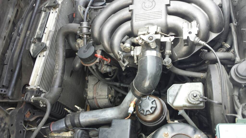

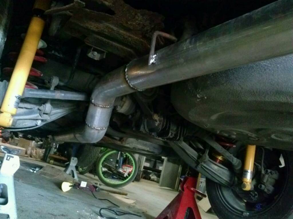

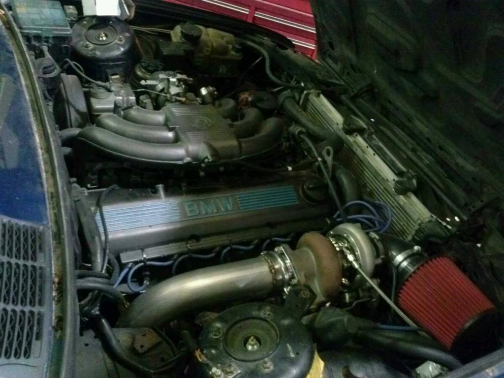

                                #300
                                My kamotors turbo install
                                Thanks kam
