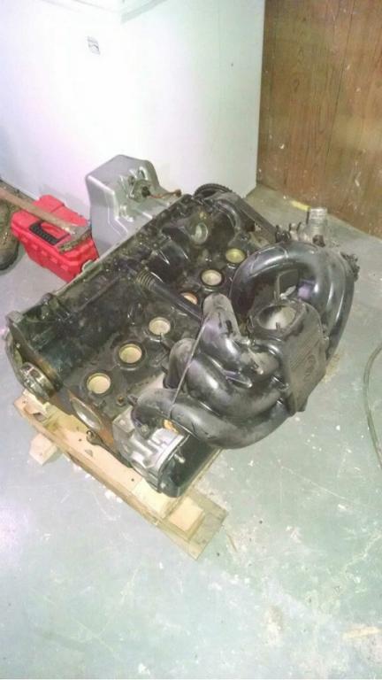

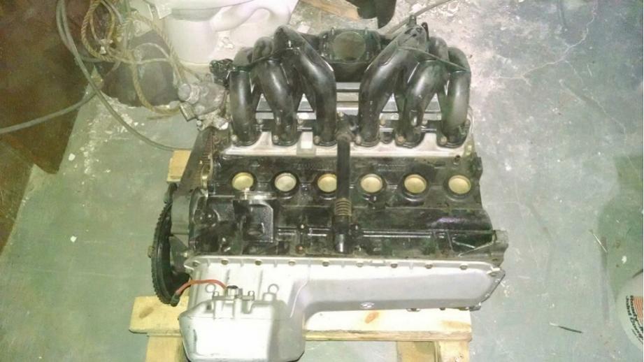

                        Well, here they are. sorry they suck and sorry i didn't dust it off, also sorry for all of my crap laying around. It was a busy weekend with my brother visiting from DC.
                        I also realized that I did not take any of the VC which sucks. I know the pics suck and I can not get anymore until I am back home on Friday but like I said I had limited time. which leads me to saying that I am currently training away from home for work but I am back every weekend, so I can only ship out over the weekends.
                        Sorry again guys, let me know if you want more detailed pics of anything. I can also pull the VC and take a head pic, but I promise it looks like an M20 head and is not all sparkly and awesome.
