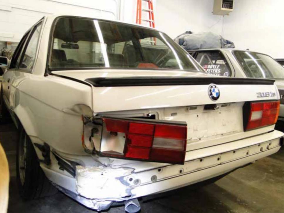

    I had this swap completed professionally over the course of 2 years, to the highest standard, by KD Motorsports in Redmond WA. No corners were cut. Then I drove it for 2 1/2 months very conservatively in the rain. The first sunny day (March 6th), I went out and had a blast driving around for a bit, and got a chance to do a full acceleration run on an onramp feeding into a long straight (148th Ave N to 520W). It was insane: You had to feather the throttle not to get wheelspin, even from 3rd to 4th. 5th gear, it was still pulling like it used to in 3rd when I had an s52 under the hood. I was laughing out loud at the ludicrous power: at 140 I was thinking "Damn! This thing could probably do 175!" then decided it best to slow down a bit. Brakes were unboosted so required a hard push to slow the car. Tires were 6 yr old, bald all seasons. The rears locked and the car went completely sideways. Fortunately there was no traffic so I had both lanes to try and collect it. And I almost did. But not quite. I slid sideways on full opposite lock for a very long way but finally the rear came around a bit too far and there was no saving it. I hit the right side jersey barrier on the left front corner just ahead of the front wheel and spun and hit the left rear before sliding out to the middle. I drove it to the side and got out, collected the parts from the highway, and called a tow truck. The car is a total.

      I am crushed. I'm a founder at a startup and we're struggling, it had been a long winter, and I was just so pumped to get out and rip around, relieve some stress. The noise alone was almost worth the price. I had not yet dialed in the brakes like Kevin suggested (it had a bias valve to adjust to the lack of boost, as well as a balance rod in the pedal cluster). Fortunately I didn't collect anybody else and I walked away.
      And of course there was a huge battle with the insurance company, who originally wanted to pay out $2300. I had to go to arbitration and they paid me $10,500 in the end. Which is a hit of about $35k. Note to self: Agreed Value Policy.

                      Damn, this sucks. Honestly though, from the photos at least, I think the body could be repaired, if I had the money I'd definitely pick it up.
                      Get a new fender, straighten the fender rail, new core support, that rear damage will be easy because you hammer from the inside of the trunk. If it didn't move the strut it should be easy, and once you add a strut bar for more rigidity...
                      And the swap and interior definitely look worth saving!

                        A body guy looked at it and said "I can fix it" but it needs a new nose and then you're left with a salvage title. You're better off finding a good roller and swapping over everything. Whatever e30 it goes into should have big brakes, good suspension, and big fresh tires.
