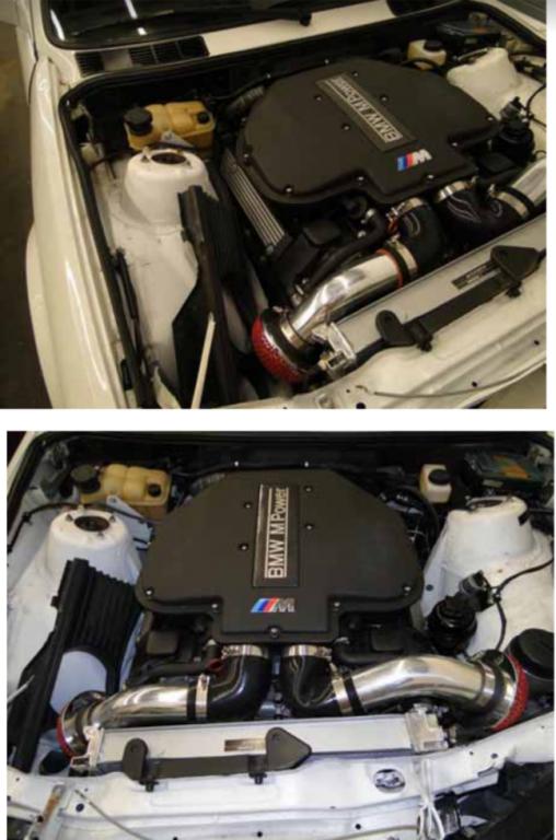

    Absolutely everything you need to accomplish the most incredible imaginable e30 engine swap.
    I am not going to pull the drivetrain from the car; it would be best if the buyer purchased the shell with the drivetrain installed so they can see how it should be done, rather than receiving a giant collection of parts. All swap parts have approximately 400 (yes, 400) miles on them. Also, shell has good usable parts. I have a folder of receipts for about $20,000 in parts that are on this car.

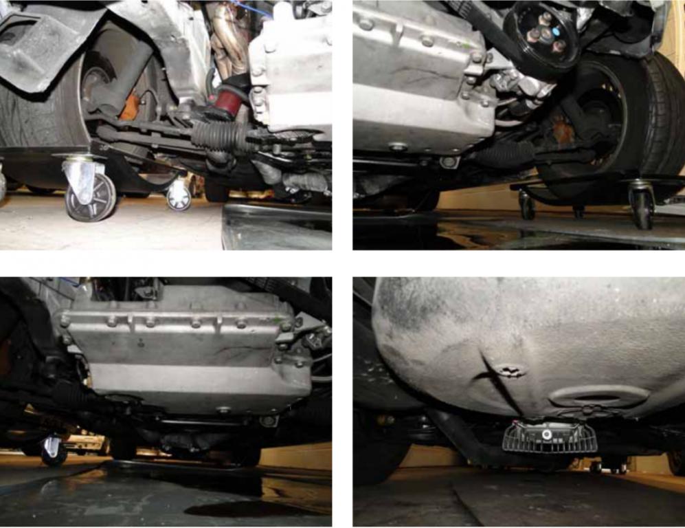

    2001 M5 S62 engine with 98K. Resealed top to bottom prior to install. Needs an oil pan (punctured in accident but was not run without oil)
    New power steering pump (needs a pulley)
    New water pump
    New Alternator/Voltage Regulator
    Garagistic M/S6x swap kit engine mounts
    Garagistic M/S6x swap kit exhaust manifolds
    Garagistic boosterless brake setup (with Wilwood pedals/MC/reservoirs)
    Factory M5 gas pedal modified to fit e30 chassis
    Custom Plug and play ECU from Ergen Motorsports. Removes security ignition lock, removes requirement for MAFs, removes requirement for O2 sensors after cat. Also adds ~25HP but I didn't get a chance to dyno it. This ECU was $2500 alone.
    Full custom stainless exhaust with switched electric cutout (sounds completely insane)
    Non-airbag steering shaft with modified steering knuckle to clear manifold, Momo hub
    Custom lightweight flywheel, HD clutch setup from UUC (this setup was over $1800)
    5spd Getrag G226 modified for S62 timing pickup (this solution from an e34 530i is considerably lighter (~30 lbs) than the e39 M5's 6 spd)
    Modified shift linkage with UUC SSK. Excellent feel and positive shift action.
    New guibo & CSB
    Garagistic custom built driveshaft ($500)
    2.93 LSD with Garagistic secondary mount and finned Z3M diff cover
    CATuned HD axles to handle extra power
    Adjustable rear subframe

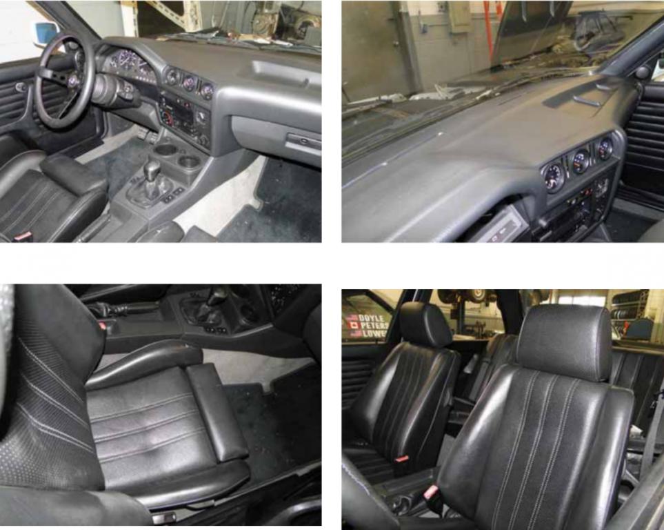

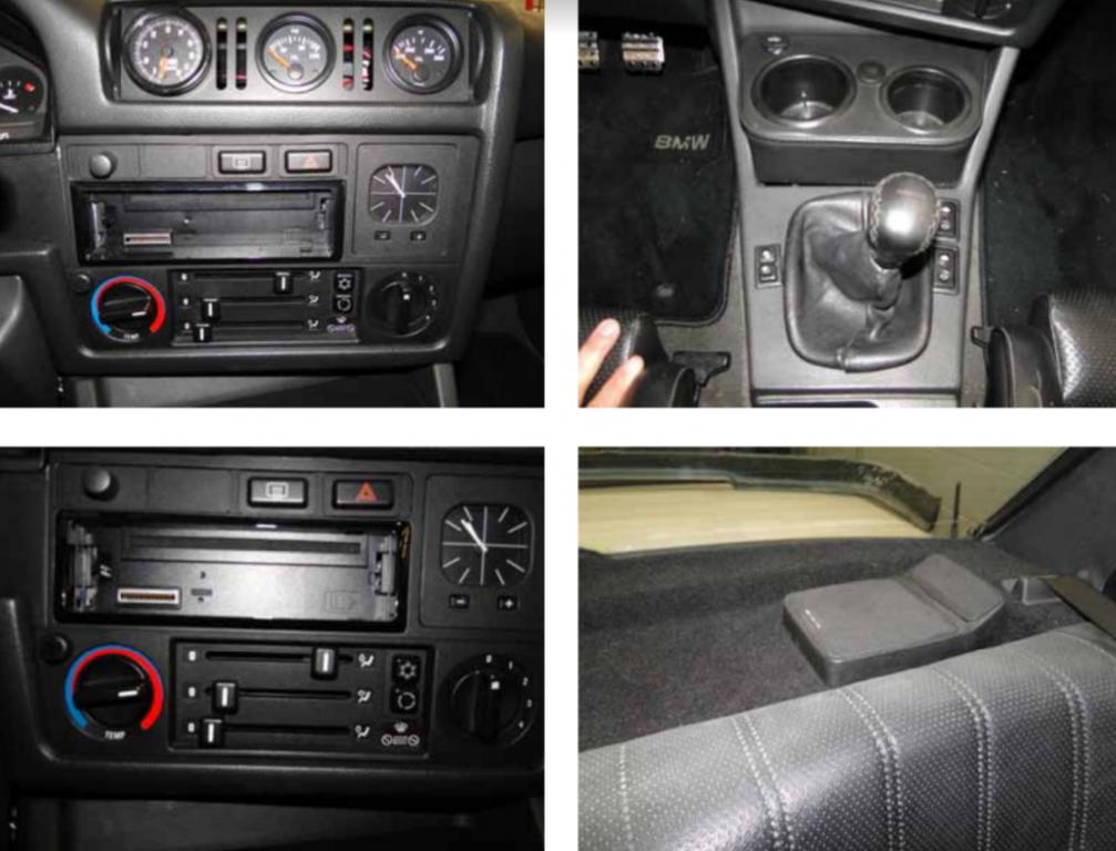

    -Full black interior, good condition, $750 (sport seats, rear seat, door panels, back panels, center console with cupholders & leather shift/ebrake boots, parcel shelf, carpet, floor mats)
    -Perfect flawless dash $200
    -VDO Instrument cluster (154K showing) $50
    -Stereo including Kenwood HU, 5ch JL Audio Amp, 10" Lukebox (with custom power/ground/speaker plugs to remove for track days), factory front and rear component speakers, all wiring, $500

      I am crushed. I'm a founder at a startup and we're struggling, it had been a long winter, and I was just so pumped to get out and rip around, relieve some stress. The noise alone was almost worth the price. I had not yet dialed in the brakes like Kevin suggested (it had a bias valve to adjust to the lack of boost, as well as a balance rod in the pedal cluster). Fortunately I didn't collect anybody else and I walked away.
      And of course there was a huge battle with the insurance company, who originally wanted to pay out $2300. I had to go to arbitration and they paid me $10,500 in the end. Which is a hit of about $35k. Note to self: Agreed Value Policy.

                      Damn, this sucks. Honestly though, from the photos at least, I think the body could be repaired, if I had the money I'd definitely pick it up.
                      Get a new fender, straighten the fender rail, new core support, that rear damage will be easy because you hammer from the inside of the trunk. If it didn't move the strut it should be easy, and once you add a strut bar for more rigidity...
                      And the swap and interior definitely look worth saving!
                      • Pipes
                        • Aug 2012
                        • 485
                        A body guy looked at it and said "I can fix it" but it needs a new nose and then you're left with a salvage title. You're better off finding a good roller and swapping over everything. Whatever e30 it goes into should have big brakes, good suspension, and big fresh tires.
