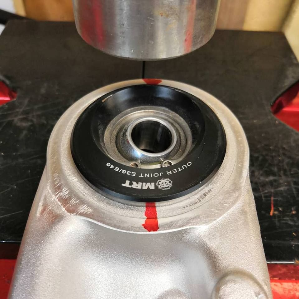

When lowering your car (BMW E30, E36, E46 etc.) the front end geometry goes wrong. The main purpose of the kit is to correct these issues. The adapter changes the wheel bearing to control arm joint distance by 30mm correcting the roll-center and camber curve, same thing applies to tie rod end which is also moved closer to control arm joint changing the lever ratio giving you quick steering and allowing way more steering angle. The new special feature is Ackermann adjuster, you can insert it either way: remain the orginal angle for street/race or decrease the angle to zero giving you desired handling for drifting and even more angle!

The kit comes with instructions, if you know how to change a control arm or an outer joint, installing this is not any harder. You'll need a press for removing the old outer joint and pushing the new adapter in. No other special tools needed. If you need any further info please contact us!
