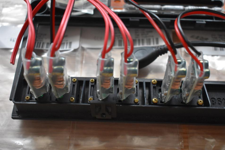

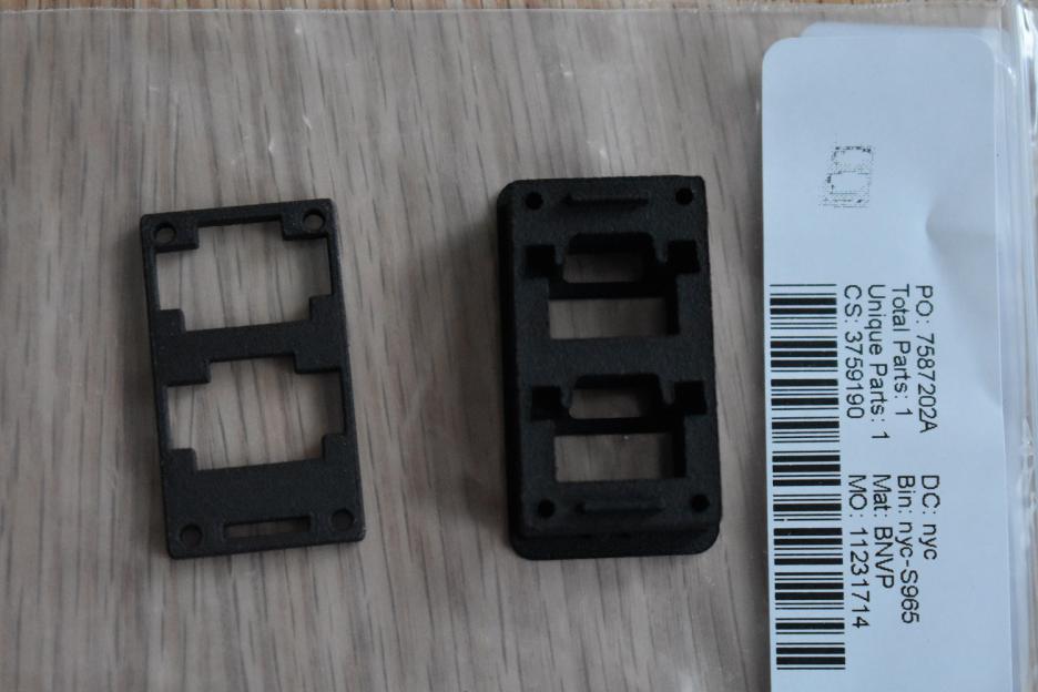

      Yes, it's a two piece part, the back piece slides and clips in on both ends, and the M2 screws hold it from sliding out. You could probably use pins or glue it on if you wanted, but the screws made the most sense to me. And yeah, I'm using QC 3.0 modules in the photo there, but it's compatible with most of the various modules available online, so it should be future-resistant. I just recently got some QC 4.0 modules which are much longer and may be making a version for those, if there's room in the dash.

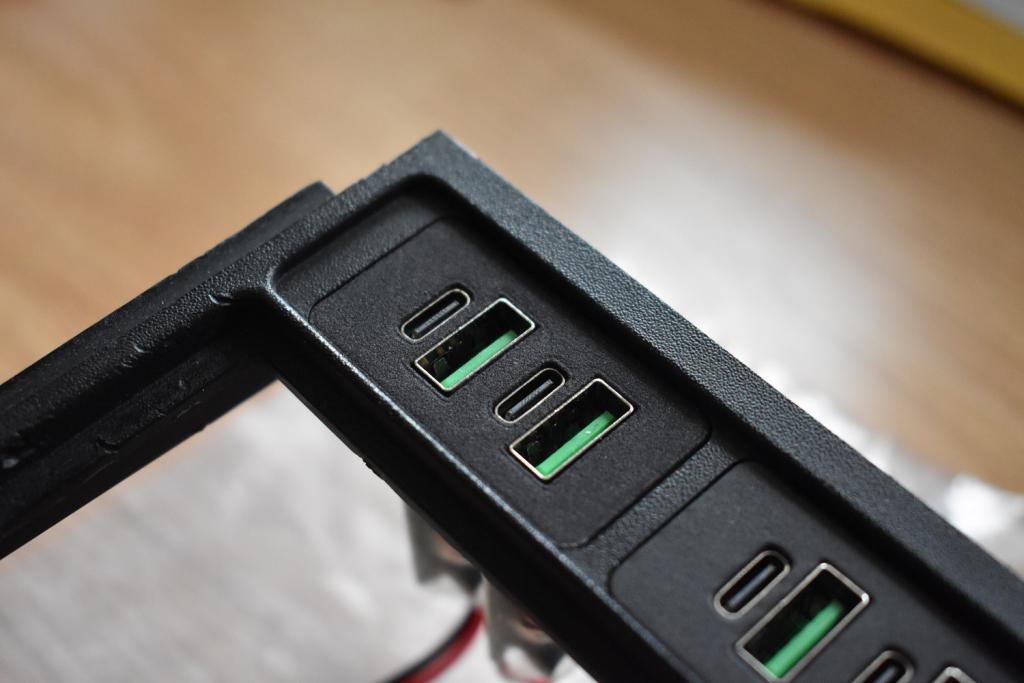

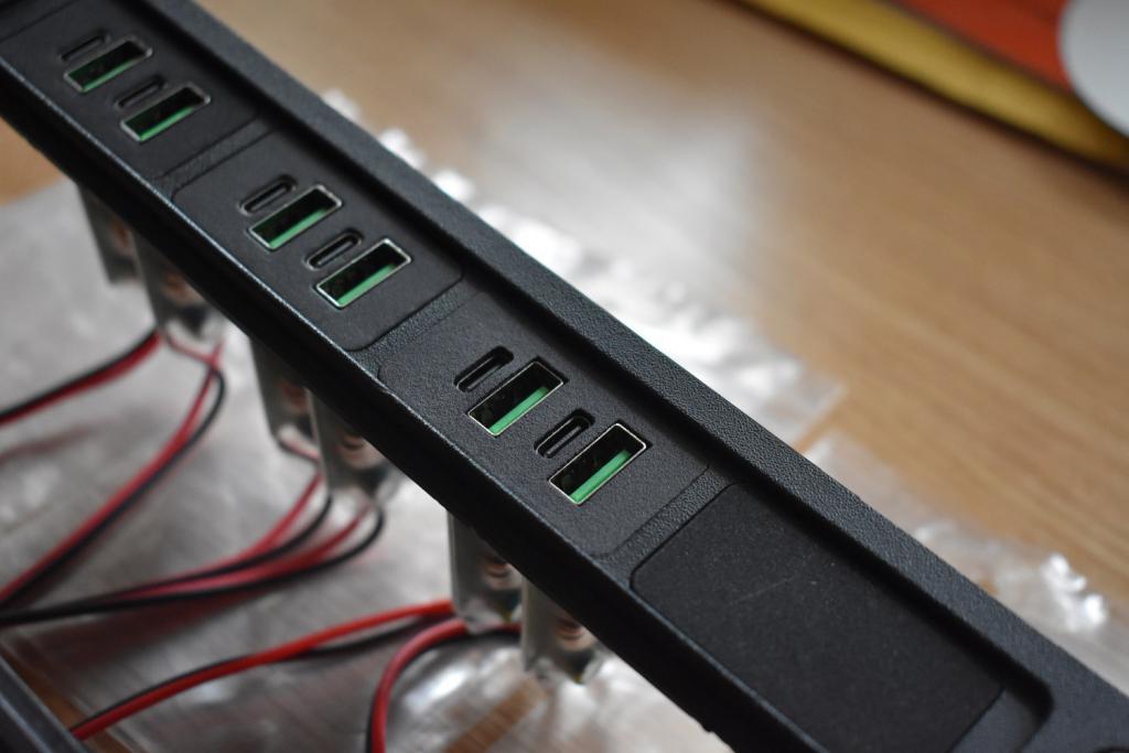

        I've created a new version which uses QC 4.0 modules, here:
        https://www.shapeways.com/product/BF...71745&li=shops
        It's designed around this module:
        It should also work with other similar modules with the same shape.

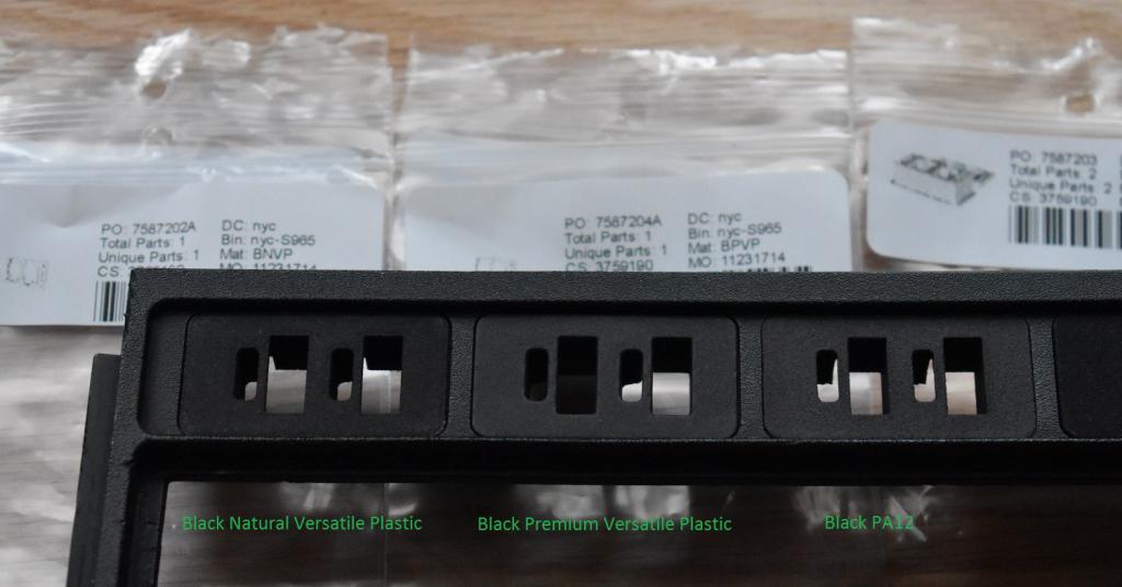

        Pictures attached. There's multiple options for material so I got one of each to show the differences. The black natural is cheapest, but PA12 looks a bit better in my opinion and doesn't cost much more. Personally, I think the premium is too expensive and not much different from the PA12, but the option's there.
        The fit was a little bit loose on some of them with the M2 screws. A dab of super glue, or using M2.5 screws, fixes that. The holes are as small as shapeways would allow me to make them, otherwise I'd shink them another 0.05mm.

            I definitely get that, but shipping everything twice and having to manage an inventory would drive the cost up considerably. Doing it this way keeps it as cheap and as fast as possible. I tried to make assembly as simple as possible to make up for it, and with the linked QC 4.0 modules, they already have the wires attached, so no soldering required.
