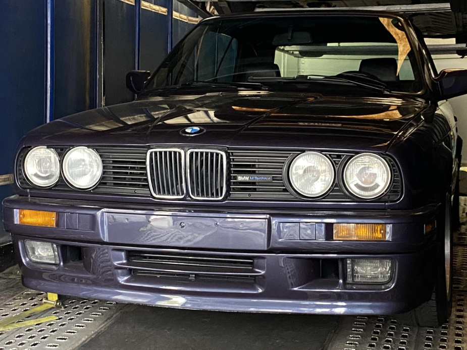

        PLEASE tell me these are still available? It's time for me to upgrade my M Technic...

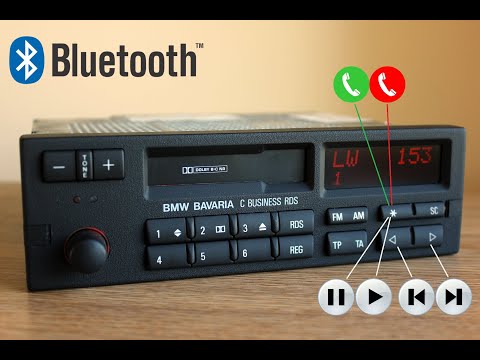

                                BMW Bavaria C Business RDS is one of the best sounding original head units BMW offered in the 90’s (made by Pioneer).
                                Besides Bluetooth the radios buttons are now also programmed for controlling smartphone (only in bt mode) 😏 AM function is disabled and used for the music input but all the other features (FM, cassette, CD changer) will function normally.
                                The price is 650$ + shipping, currently all are sold but if interested I can add you in the queue for the next ones.​
