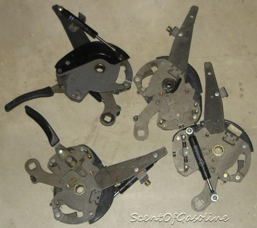

Let me know. Mine slips. Looking for one that is does not slip.

guys... these dont slip... the bracket stop clicking in because you need to replace the tiny spring in the front. 9 times out of 10, you just have to clean the spring, pull it out a little bit and slap it back in.
In the above picture, the only one with the spring is the bottom right.Comment
Ok, that's good. I will have to take it apart and check it out.guys... these dont slip... the bracket stop clicking in because you need to replace the tiny spring in the front. 9 times out of 10, you just have to clean the spring, pull it out a little bit and slap it back in.
